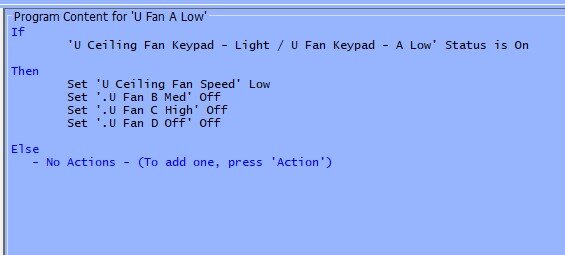

I have done something similar using just scenes, but it is pretty convoluted in my opinion.  You have to set a key "on" status to "off" and the like.
So, I generally use programs to do this.  I find them easier to understand and maintain.
Create a scene for each key and assign just the one key as a controller for the scene.  The create a program for each key that, when triggered, executes whatever you want to do but also turns the other key scenes off.
I use this procedure for my ceiling fan buttons.  When I press the 'low" button, it sets the fan to low and turns the other buttons off.   Similar programs for med, high and off.
I group all my key programs in a folder for readability.
You have to create a scene for each key because, while you can recognize a key press in an if statement, you can't control a specific key in the resulting then/else.  So, you control via the scene.

14 hours ago, MTellevik said:
I Apologize if this is in the wrong spot, let me know and I'll repost it correctly.
Newbie question:
I have a 6 Button Keypad Linc 2487S I would like the C and D buttons to be mutually exclusive.
If I press C then C would be on and D would be off
If I press D then D would be on and C woiuld be off.
I know this should be simple but I just cannot get it working. 😡

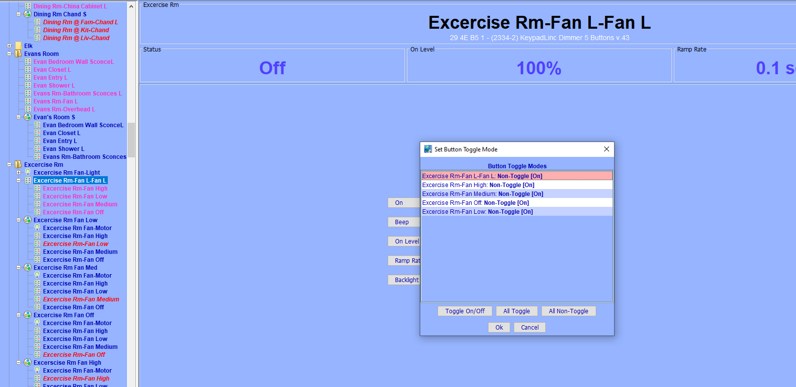

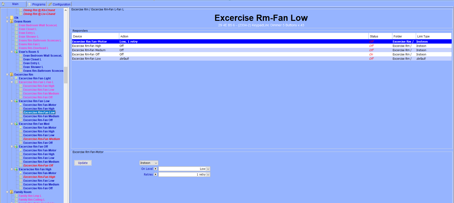

I have this setup for several KPL, though I did 4 buttons, I use this to control fan speeds.
Create 2 scenes.  One For each button
Add both buttons to each scene.
 - Button C is controller for Scene C, Button D Controller for Scene D
Set the "on level" for D button to "off" in Scene C, and similarly, set the "on level" for button C to "off" for Scene D
- remember to do this both for the primary scene, and for when the scene is controlled by the button (from the device tree on the left, click on the scene, set the on levels, then click on the other controller for each scene (button c in scened c) and set the on levels there as well. Note: In the device tree on the left, controllers in a scene will be in red letters.
Main Scene Setting On levels
Now for the controller, in this case, fan low.
Finally click on the KPL in the tree on the left, and in the right pane at the bottom, click on "toggle mode", and set button C and D to be "toggle on" only.
EDIT:  I should also mention that you will want to add as responders to the scene whatever action you want.  In my case a fan.  Or, if the only thing these buttons are controlling are programs, then just put the status of the button in the "if" part of your program.  We call these "radio buttons", like how old fashioned car radio buttons worked, push one in, the other pops out.  This works when the buttons are controlled by direct press, and it works when the scenes are turned on by other methods, for example, a program, or Alexa, or even another Insteon device (you can add other insteon devices as controllers to the scene if you like, just remember to again set the "on levels" for that controller.  With my fans, I can turn them on from Alexa (via a program) and it sets the buttons correctly.  If I say "Alexa, fan high" for example, it will trigger the fan high scene and the high button turns on and whatever other button that was on turns off.
