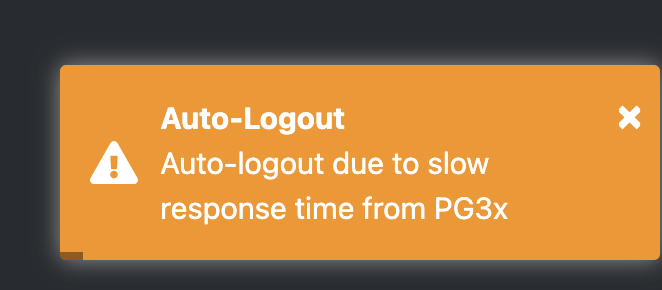

OK, so did the backup, and upgraded Java as well. Rebooted and things looked fine, so I did the update, got a prompt to reboot and did so. Logged in and looked around a bit, then rebooted manually as you suggested.
Seemed fine, but when I went into Polyglot, I had some trouble logging in, eventually did but then got logged out right away with this message:
Retried it a few times, and eventually got in. So far things seem to be working normally again now, but that was a little bit weird.
@smorgasbord glad you got it sorted out. It is an odd error though and one that has shown up before, but not commented on recently. If it happens again (soon) try running the upgrade packages again and reboot then power cycle.
Are you using UD Mobile? Is it up to date?
If it happens again start a ticket before doing too much self troubleshooting or “repair” (other than update process or power cycles). As it would be beneficial to UD to see what is happening so if it’s a bug they can repair for the rest of us.
I am using UD Mobile on my iPhone and it is up to date. Don't see anything in Notifications that isn't from my debugging set ups. The UD Web Interface seems OK, too. Polyglot is fine now, too.
It seemed that maybe something was going on after the update/reboot that consumed the CPU and so I got that message. Eventually the something ended and all seems just fine now, thanks.
