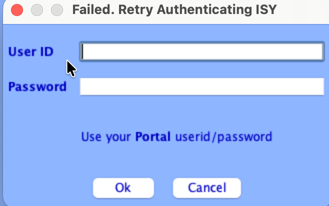

woodchip Posted Monday at 01:57 PM Posted Monday at 01:57 PM When I log into eisy on PC I am now asked to login using my Portial username and password. I am also getting an error popup window titled "AutoUpdate Status" stating "Failed retrieving product information". Any assistance or direction regarding these issues would be appriciated. Quote

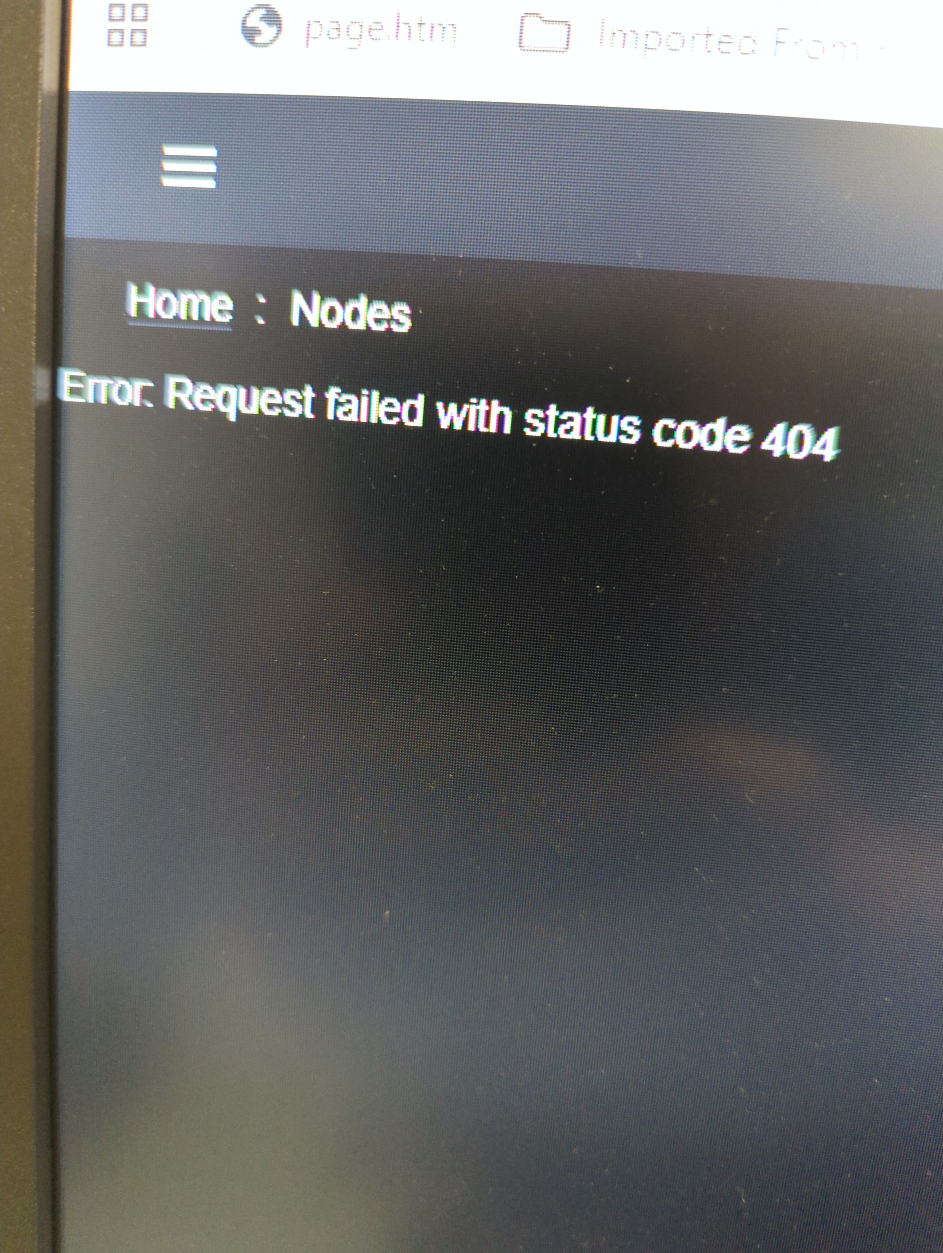

BobM99 Posted Monday at 04:04 PM Posted Monday at 04:04 PM And getting this when looking for nodes.... Quote
woodchip Posted Monday at 04:47 PM Author Posted Monday at 04:47 PM (edited) 42 minutes ago, BobM99 said: And getting this when looking for nodes.... Edited Monday at 04:48 PM by woodchip Missing text in reply Quote
bmercier Posted Monday at 04:48 PM Posted Monday at 04:48 PM 2 hours ago, mmb said: Same on eisy. @bmercier is this a concern? The login with portal credentials is expected. The auto-update, I'm not sure. Quote
woodchip Posted Monday at 04:49 PM Author Posted Monday at 04:49 PM Once I reset my password and logged in all of my nodes were present. Quote

bmercier Posted Monday at 05:19 PM Posted Monday at 05:19 PM 29 minutes ago, woodchip said: Once I reset my password and logged in all of my nodes were present. Can you PM me your uuid? I believe it was just a matter of timing. Quote

AKAPADIA Posted Monday at 05:51 PM Posted Monday at 05:51 PM 1 hour ago, BobM99 said: And getting this when looking for nodes.... I am also getting this. After I changed my password, I saw the nodes show briefly with a moving blue horizontal bar for a few seconds flashing as if it was still loading, but then it reverted to the HTTP 404 error. Quote

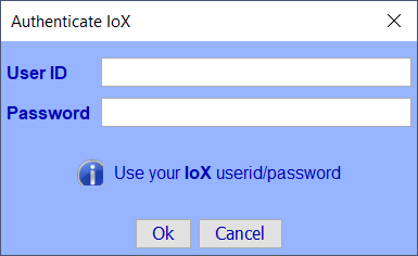

polo2883 Posted Monday at 06:22 PM Posted Monday at 06:22 PM I cant seem to login with my admin user. It keeps saying Quote
AKAPADIA Posted Monday at 06:24 PM Posted Monday at 06:24 PM 1 minute ago, polo2883 said: I cant seem to login with my admin user. It keeps saying Assuming you are using the portal userid and not the old IoX user Ids? Quote
