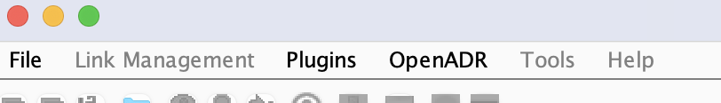

This is what my toolbar looks like
I still have a red flag at the bottom of my GUI as well

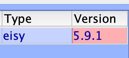

2 hours ago, andrew77 said:
Will it let me know when its done?
1 hour ago, andrew77 said:
I'm still waiting for something on my computer telling me its okay to reboot etc.
Its been about two hours since the last message which said PG3 is starting
The release note seemed to indicate there would be an indication as to when to reboot. I have not updated yet so not sure if it does. I think after 2 hours would be okay to reboot. More than likely (are you on macOS?) the admin console window lost the connection to the device and isn't updating. If your mobile device said the device restarted it might be fine to force a reboot. Since I haven't updated not sure what to expect. Letting all you early adopters go through this before I take the plunge. I'm also not local to my device and don't want to blow an evening trying to update it just for a web ui that I don't really want/need to use.
