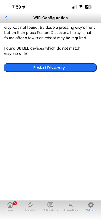

My router keeps giving EISY the same address.... I try adding that address to IoX Finder as well as eisy.local and neither work....yet the router has the EISY listedIMG_4625.PNG

10 hours ago, kmosmen said:
I have done both....
Is this screen shot from UD Mobile?
Does the DHCP table in your router show eisy connected, or offline?
From the above, it appears you are trying to connect eisy via wifi, is that correct?
If so, can you temporarily move eisy near your router and connect via an ethernet cable?
If you are trying to connect via wifi, it is possible eisy is not in wifi configuration mode. Hence the message to try double pressing eisy's front button, which will place eisy in wifi configuration mode.
It would help if you could explain how you are trying to connect to eisy, are you using a computer, UD Mobile, ios, android?

Note: Some iOS and Mac devices may not allow data transfer to a WiFi access point (eisy) if the access point does not have internet access. This will prevent setting of your Home Wifi credentials on eisy. If UD Mobile shows an error message similar to "The internet connection appears to be offline" then please try our Alpha Bluetooth setup https://youtu.be/NrVFYfXRaxc.
Most issues with eisy WiFi configuration are related to eisy not being in WiFi Setup Mode, denied mobile device permissions, or eisy's WiFi network was entered manually into the Mobile device.
Verify eisy is in WiFi Setup Mode by opening your mobile device WiFi settings and verify a network prefixed with "eisy" is available. DO NOT CONNECT TO THIS NETWORK or the app will not be able to complete configuration. If this network is saved by your mobile device please forget the network before attempting setup.

My backstory.... My PLM wasn't working so I ordered a new one. Got the system up and running. For Back Friday, I decided to upgrade my old Google Home router with an Orbi 770 system. My old Google router offered a 192.168.86.xx SSID. The new Orbi defaulted to a 10.0.0.xx SSID. I didn't know that when I swapped routers. (I disconnected the Google router and made the new Orbi have the same Network name and password - thinking the devices wouldn't know!). Many things connected but the EISY wouldn't connect. I then changed the SSID of the new router to the 192.168.86.xx. EISY was still connected via a wired connection - it gets an ip address from that connection but IoX Launcher will not connect. No user name / password option....just NOT FOUND popping up. I don't know how to ping the address on a Mac but I do run Parallel's for another work program. Maybe there? Nonetheless, I just checked and the IP address for the EISY remains.....192.168.86.XX and it hasn't changed.
I did create a ticket but am getting very vague, SUPER SHORT instructions on how to fix this. I tried the 10 presses of the power button to factory reset since I have a good backup from 11/26/25. Completely at a loss here..... and super frustrated!!! Wishing I had the money to throw my Insteon out and get something with better now but my entire house is INSTEON! Ugh.
Thank you!!!!!
(Double pressing the power button does not broadcast a wifi network from the EISY. I have tried a million times...)
