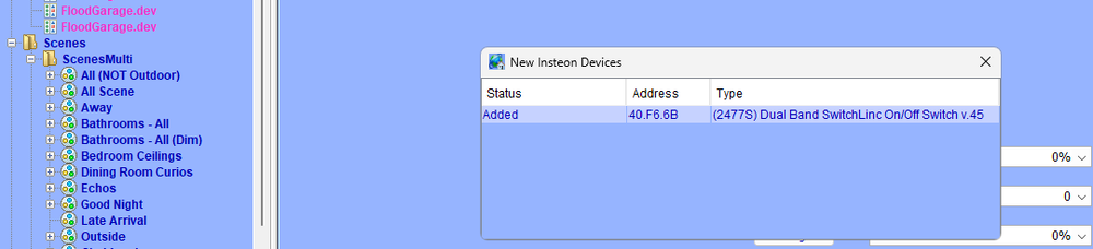

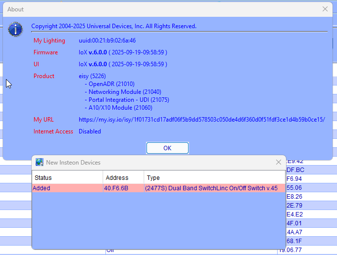

I have an eisy with iOx 6.0.0. I recently added a new 2477S switch. Something seems to have gotten corrupted as there was a duplicate entry. I tried deleting both deviced and would attempt to link again, but every time I launch the admin console, the New Insteon Devices box pops up saying the switch was added but it is not showing up in the list. There are no other buttons on the pop up. Any ideas how to fix this? Thank you.

Thanks for the responses. I removed both instances of the switch, did a factory reset of the switch and then rebooted the eisy. I added the switch again using linking, tested it and then added it to the scene. Unfortunately, once again, the switch is duplicated and the New Device box pops up.

It might be good to open a support ticket with this issue. It could be a bug that needs further testing. As @hart2hart suggests it's a "known" issue, but what you're experiencing might be different and would need to be diagnosed if it's seemingly working, but later making a duplicate.

But did you try rebooting the eisy after adding it back? That appears to be the workaround suggested.
Interesting. I am not sure how I missed that. OK. It seems to work now. Though when I logged in, I had to re-query all the devices one time. After I logged out and back in again, everything seems to be working fine. Thank you so much everyone.
