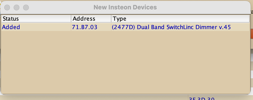

I'm trying to replace what I believe is a faulty SWL with a brand new one.
But I can get into Start Linking because this keeps popping up
If for whatever reason your ISY is stuck in this state, you will just have to power cycle it, even though it says don't do that. There are legit reasons for this message, but they shouldn't persist. So if hours go by and this still happens, you will need a power cycle.

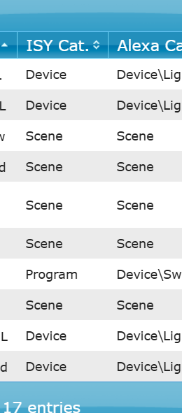

When you open the ISY portal and go to Amazon echo:
Is the "ISY category" for whatever it is listed as a "scene" or "device"?
They are all listed as scenes
When I trigger the scene in the GUI the GUI says the light changed but in reality it hasnt
Also, this keeps opening when I open the GUI
So the problem is with ISY, not Alexa. If the light doesn't turn on when you turn the scene on from the ISY admin console it isn't going to turn on when Alexa triggers it either.
I have also had this (edit, by this I mean it keeps doing the pop up) happen after adding a device and ended up having to power cycle ISY. A bug in one of the more recent firmwares I guess. I have now seen at least a couple other people report this.
I would start with rebooting your ISY (eisy/polisy/whatever model). Then see if the scene works. My bet, however, is it will not. Perhaps the "replace with" command did not function correctly. You can always try a "restore device", but I usually just completely delete the device, add it back, and configure it back into all the scenes.
You might want to open a support ticket with UD on this one. Seems like you added a device and it might not have completed accurately. You might need to remove it, reset the device, and add it again. But support might be able to give you other troubleshooting tips.
I have had this same problem after adding a device. It did add the device, and the device worked properly, but the popup just keeps happening every time I opened a new admin console session. After rebooting eisy it stopped. I feel like it is a firmware bug. I have added multiple devices and it didn't happen every time. I never saw this problem in the 15 plus years I have had an ISY until just a few months ago.
Regarding the OP's issue. I think the scene is corrupted. I would delete the device completely from ISY, factory reset it, add the device back into ISY, and then put it back into the various scenes. Hopefully it isn't a super complicated set of scenes/programs.
