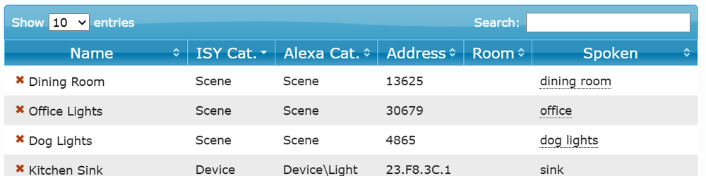

I'm referring to the portal, not Admin Console. When you defined the Alexa spoken in the portal, what did you click on at the top? "Device" or "Scene"?
You need to click on Scene, and then select the scene from the list (you'll see scene names instead of device names)
