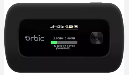

So, I am going to think outside of the possible eISY solutions (gasp!). I have a spare Verizon HotSpot laying around. I am going to try that with my router plugged into a wi-fi plug connected to the HotSpot. In theory, as long as I have cell service to the location, I can connect in remotely and tell it to reboot. Plugs will be here shortly and I'll give it a try.

This device won't be dependent on the router wi-fi, but will use the wi-fi from the Verizon hotspot. So I can tell the plug via the plug app to turn off and on to reboot the router but the access to the plug won't be affected since it is on an independant wi-fi network..

My HotSpot is a separate cellular device that uses the cell towers for wi-fi access. It is not related or dependent on my router at all. I'll keep it in the same closet as my router where the wi-fi plug will be used. So I'll be able to reach the plug when I can't reach my router. And then just tell the plug to turn off and back on again. And yes, the app that works with the plug will work from anywhere.

Oh so you have a backup Internet access system, using a mobile cell signal device. That works.

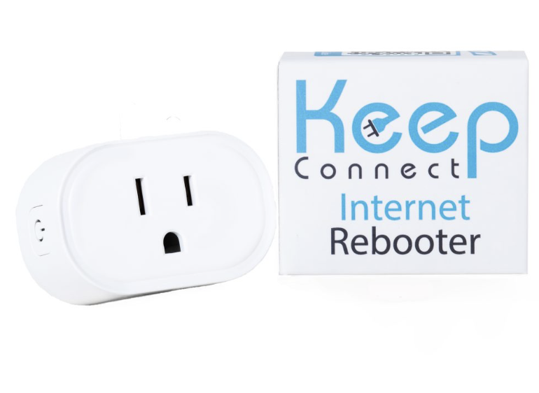

Smart outlet with hardware built-in watchdog that monitors your gateway connectivity
Keep Connect | Automatic Router Rebooter
Rebooter Pro – Automatic Router and Modem Rebooter
