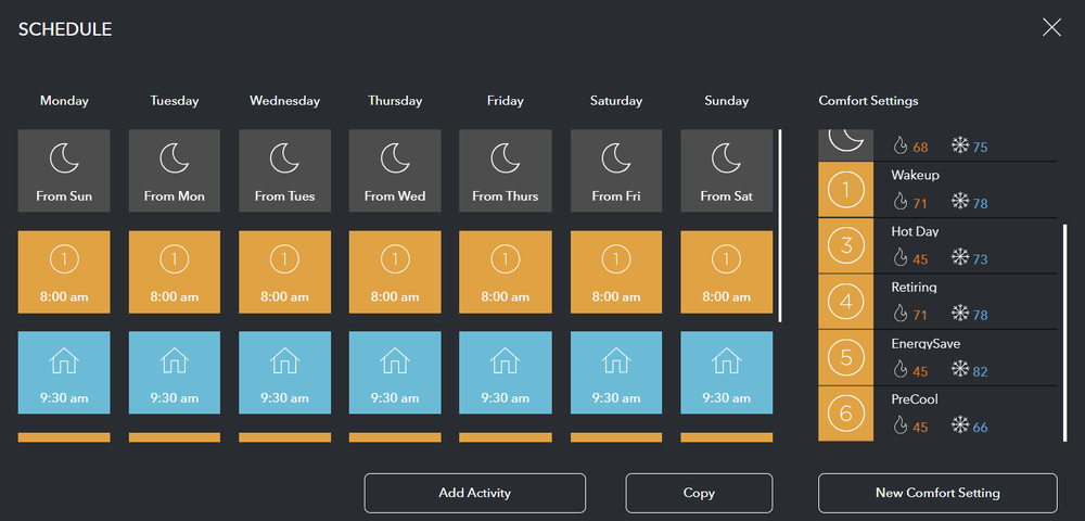

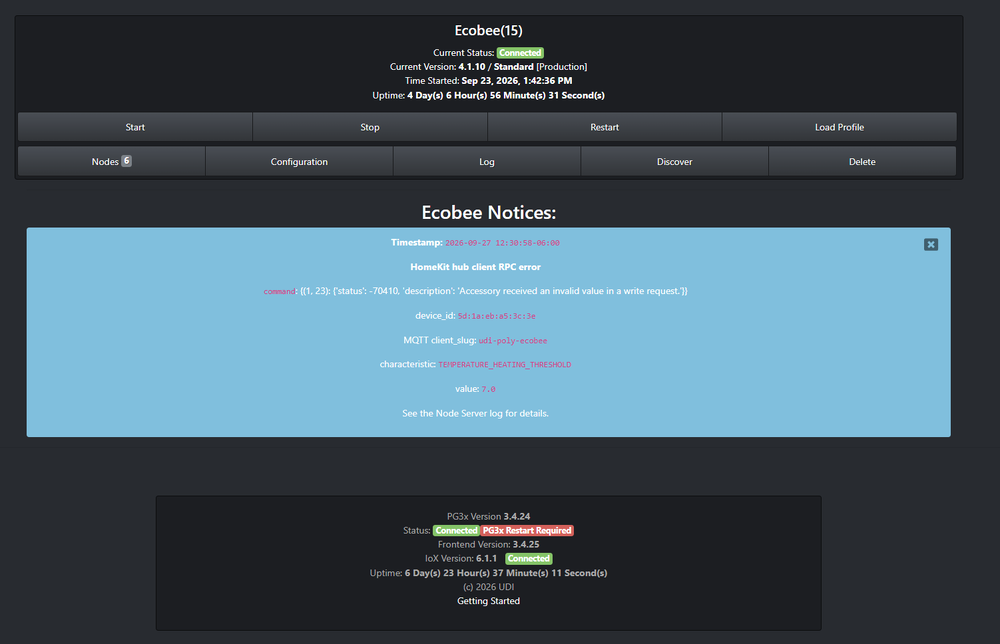

After updating to the latest system releases my ecobee plugin is working again. However I'm getting some errors from the plugin that I don't understand.
I have renamed smart5 and smart6 (see below) to PreCool and EnergySave .
Whenever I set the climate type to either PreCool or EnergySave I get an error, see further below:
I attached text from the debug log
ecobee debug log.txt
@photogeek54 Update to 4.1.11 and confirm

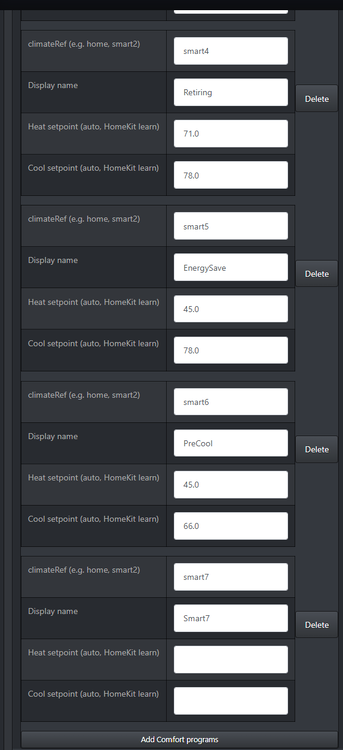

My biggest problem remains how to set the comfort programs and have them stay. They keep resetting to smart1,2,3,4 etc.
Even though I can't view them currently after migrating the plugin to eisy-ui, I'm assuming they would get transferred there if I could set them in pg3 and them migrate?
Ignoring the eisy-ui issue
My biggest problem remains how to set the comfort programs and have them stay in PG3. They keep resetting to smart1,2,3,4 etc.
This seems to be a PG3 Ecobee issue
Do not change the "climateRef" only change the "Display name", if I could make it readonly I would, but not possible. I've confirmed over many restarts that display name doesn't get reset. Again, for new issues please create a new post. Also, read the notes about how comfort programs are now handled in the version I just released, I've given up trying to hack a way to deal with them due to HomeKit not supporting them.
