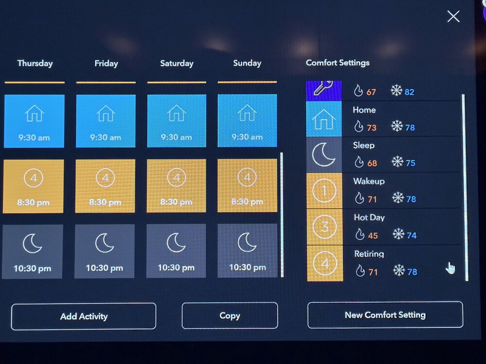

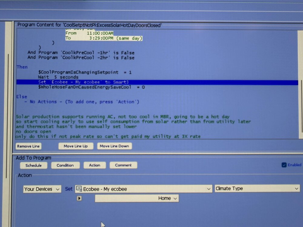

June 23Jun 23 So I updated my programs to use the new ecobee plugin and there are a few things that look strange. I have added 3 new climate types to my ecobee, "wakeup", "hot day" and "retiring". In ecobee I only see one additional climate type it calls "smart1", not sure which of those it is and 2 missing. In one of my programs it is trying to set climate type to "smart3" but the action below for that row calls it "home". I've attached photos.
Tuesday at 01:34 PM5 days Yes that's one thing missing with Homekit mode. I check again but I think that smart1 was the only extra one available and I neglected to test how that actually worked. I'm not sure how smart3 showed up but will check as well.

Tuesday at 11:46 PM5 days 19 hours ago, photogeek54 said:So I updated my programs to use the new ecobee plugin and there are a few things that look strange. I have added 3 new climate types to my ecobee, "wakeup", "hot day" and "retiring". In ecobee I only see one additional climate type it calls "smart1", not sure which of those it is and 2 missing. In one of my programs it is trying to set climate type to "smart3" but the action below for that row calls it "home". I've attached photos.This is the best I can figure out, but it's a pain, released in 4.1.10https://github.com/UniversalDevicesInc-PG3/udi-poly-ecobee/blob/master/README.md#homekit-climate-type-no-cloud-apiNot sure if I'm going to use this, I still haven't customized all this in our new home yet but it seems to work. I may just use climate settings in the ISY instead of relying on the ones set in the ecobee app.51 minutes ago, BJB2757 said:Jim, my Ecobee is set to require a minimum of 2 degrees between the heat and cool setpoints. But the plug-in seems to be enforcing a 3 degree minimum delta between hot and cold. Is this something that can be changed? Thanks:) -BarryTry 4.1.10, see the setting in the config page. We can't read the setting from the thermostat in HK mode then set hk_heat_cool_min_delta https://github.com/UniversalDevicesInc-PG3/udi-poly-ecobee/blob/master/CONFIG.md#homekit-thermostat-node-drivers-and-commands
