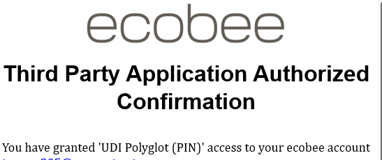

19 hours ago19 hr I just received an email from ecobee acknowledging UDI access. I stopped the plugin days ago when the trouble started. I restarted it but still only the controller node. Tried discover but no luck.When I looked in the log there are no errors, the plugin seems to be able to access ecobee, not sure why the thermostats don't populate.
18 hours ago18 hr I've been working with Michele and we discovered Ecobee has shut us down. No path forward at this point. Will continue to investigate.
