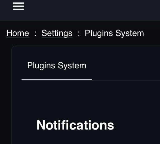

What do you see if you're logged into eisy_ui and click the three bars on the top left? Go to settings then what do you see? Should see similar to this:
If not, then I might agree about an update issue and you should have UD focus on that issue. Strange that @someguy is having IPv6 issues. Hopefully support is able to get those sorted out and make sure others don't suddenly have the same issue.

No, I still do not have a portal tab in eisy-ui. I will have to focus on that another day.
Thanks for the input, everyone.
Hopefully final update: Safari now has a portal tab after logging out and back in.
According to Benoit, certain features are disabled in eisy-ui when there is no internet access. I guess that means they disappear completely from the UI, which is a bit confusing. So, now that my portal access is restored, the feature is back, but it required a logout.
