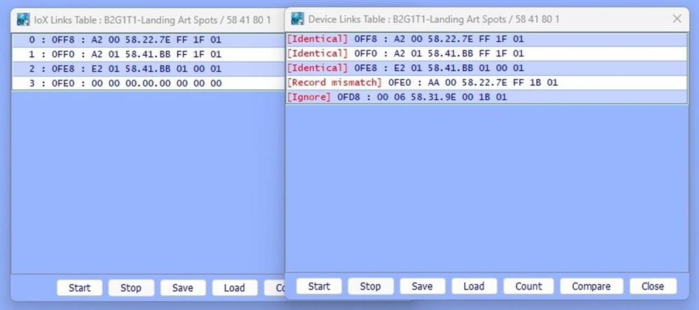

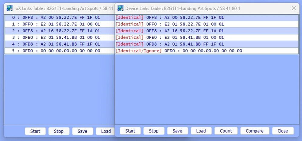

3 hours ago3 hr Author 26 minutes ago, IndyMike said:Before and after you remove/re-add the devices to a scene.IOX table vs a device that has Not been fixed via the scene delete/re-add procedure.I did this with the same device. The first picture is the before, and the second picture is the after. The scene could not be controlled by the eISY before and now it can. Note that the scene worked fine when either device was the controller, so the native Insteon scene remained intact (which makes sense).Note: 58.22.7E is the PLM.I'd love to hear any thoughts/ideas. Thanks!
1 hour ago1 hr @TheRydad , I apologize, but my thoughts and ideas are coming rather lame. The behaviour you are describing makes sense based on the link tables. I don't really understand why this occurred, and don't have an easy solution. It's possible the power interrupt resulted in a FUBAR event. Regardless, I would suggest you open a ticket to see if UD can offer a recover path that doesn't involve deleting/adding 100's of scenes - that would be obscene (offense intended).I've commented your original table below. What is significant is what is NOT shown. Your device at 58.41.80 has group 0 responder links to the PLM at 58.22.7E (Addr 0FF8). It has no controller link (Flag E2) to the PLM. It can't communicate any local changes to the PLM.Your device can control and respond to the device @58.41.BB - it is a scene member (Addr 0FF0 and 0FE8)CountAddrFlagGroupAddrDataDescription00FF8A20058.22.7EFF1F01Responder to Group0 PLM10FF0A20158.41.BBFF1F01Responder to Group1 58.41.BB20FE8E20158.41.BB010001Controller of Group1 58.42.BB30FE0AA0058.22.7EFF1B01Duplicate responder to Group 0 PLM40FD8000658.31.9E001B01End of recordThe Scene delete/add fix a couple of things (highlighted): Your device at 58.41.80 has group 0 responder links to the PLM at 58.22.7E (Addr 0FF8). It has a controller link (Flag E2) to the PLM at Addr 0FF0. Your device is not a responder to Group 16 as controller by the PLM (Addr 0FE8). This is the scene link you were missing.Your device can control and respond to the device @58.41.BB - it is a scene member (Addr 0FE0 and 0FD8)CountAddrFlagGroupAddrDataDescription00FF8A30058.22.7EFF0101Responder to Group0 PLM10FF0E20158.22.7E010001Controller of Group1 PLM20FE8A21658.22.7EFF1A01Responder of Group 16 PLM30FE0E20158.41.BB010001Controller of Group1 58.42.BB40FD8A20158.41.BBFF1F01Responder of Group1 58.42.BB50FD0000000.00.00000000End of record
