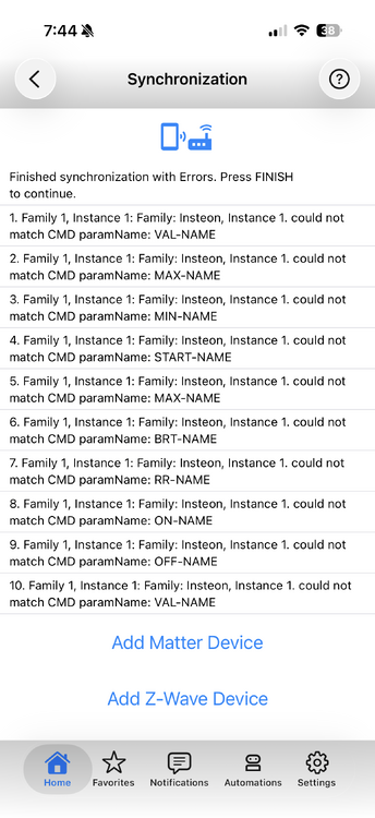

Hi @Javi , I see these errors on sync after installing the major update today.
They don’t seem to be causing any functionality issues.
Can you help me understand what they are?
Thanks!

I have the same type of error with insteon devices upon sync. Other than that have not had any issues with the upgrade with the exception of not being able to use the java app. I retrieved the newest app from the site but get the error "this version of the admin console is not compatible etc.". The admin console I downloaded is 6.0.5. Has the java been deprecated already?
