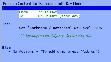

August 20Aug 20 I had three programs that would set the bathroom light on level to 100% in the day, 70% after 7:00 PM and 30% after 11:PM and then back to 100% at 6 AM. My then statement now have a line that says //Unsupported Adjust Scene Action. Did the capability of setting light levels in a scene get removed as it was working fine for a long time. Edited August 20Aug 20 by epete

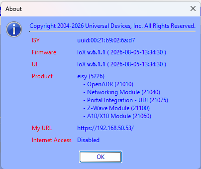

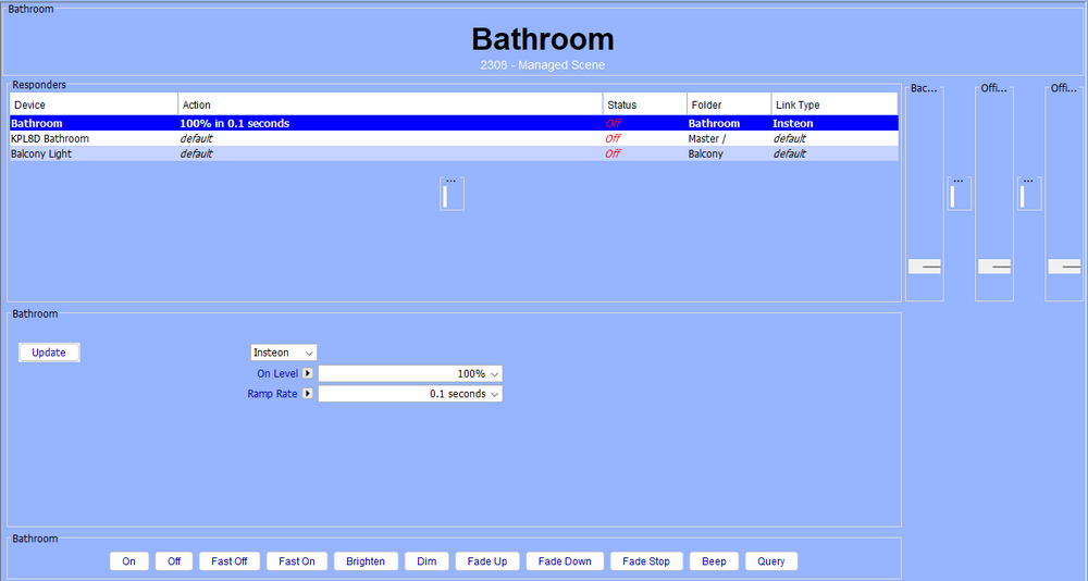

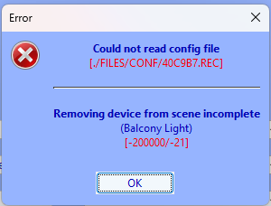

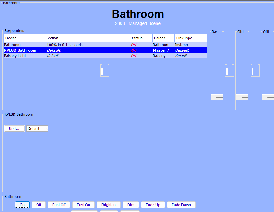

August 21Aug 21 Author I did update after seeing the update email from Universal Devices, but this problem started before the update. Below is one of the programs that Set the Bathroom Scene on Level back to 100% at 7:01 AM which is located in the Bathroom folder I do now see that something has been corrupted as the scene somehow has my Balcony light in itand after the update I had noticed by balcony Light Disappeared from the ISY Node altogether, so I had re-linked it. The Insteon Address printed on the device was 51.A5.D6. I had tried adding it manually and it would not add. I then tried by pressing and holding the button on the Insteon Device and selected start linking button to let eISY find it. When it was found the address that was read was 51.A3.D6. I can control both the bathroom light and balcony light from the Admin Console. I can also press the KeypadLink D button (KPLD Bathroom) and turn on the scene. When I have the Bathroom Scene selected and click On or Fast On, it does not turn on.I also see some corruption on teh screen which I always assumed was low memory for video.Clicking Remove from Scene option for the Balcony Light gives me this errorAnd trying to delete the bathroom scene to start over gives me this errorSo I am fully stuck.Additional info Sorry Geddy, I just saw your instruction not to post screenshots
August 21Aug 21 Author Here is the text copy of the programBathroom Light Day Mode - [ID 004D][Parent 0001]If From 7:01:00AM To 6:59:00PM (same day) Then Set 'Bathroom / Bathroom' On Level 100% // Unsupported Adjust Scene Action Else - No Actions - (To add one, press 'Action')
August 21Aug 21 Maybe try recreating the scene manually? If the new one works, then delete the old, corrupted one.

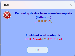

August 21Aug 21 Author right, See the 4th and 5th picture showing the error I get when trying to delete the Balcony switch from the scene and the error from just trying to delete the scene.
August 21Aug 21 19 minutes ago, epete said:And trying to delete the bathroom scene to start over gives me this errorMaybe move the scene out of the folder. I'm not sure if that's stopping it or not, but sometimes items inside a folder can't be deleted. I know that goes for using the replace device option. Odd that you have what's printed on the label being a 5, but it added with a 3. I've heard about zeros being Ds or 8s and S being 5, but not 5 to 3. That's due to font issues.
August 21Aug 21 Author I can only drag the scene into another folder. It gives me a Circle with line through it when I try to drag to the Network or ISY level.on the Insteon Address thing, I cannot remember if this was a problem when I first set it up or maybe something got corrupt in the device over time and maybe that is why it disappeared from eISY
