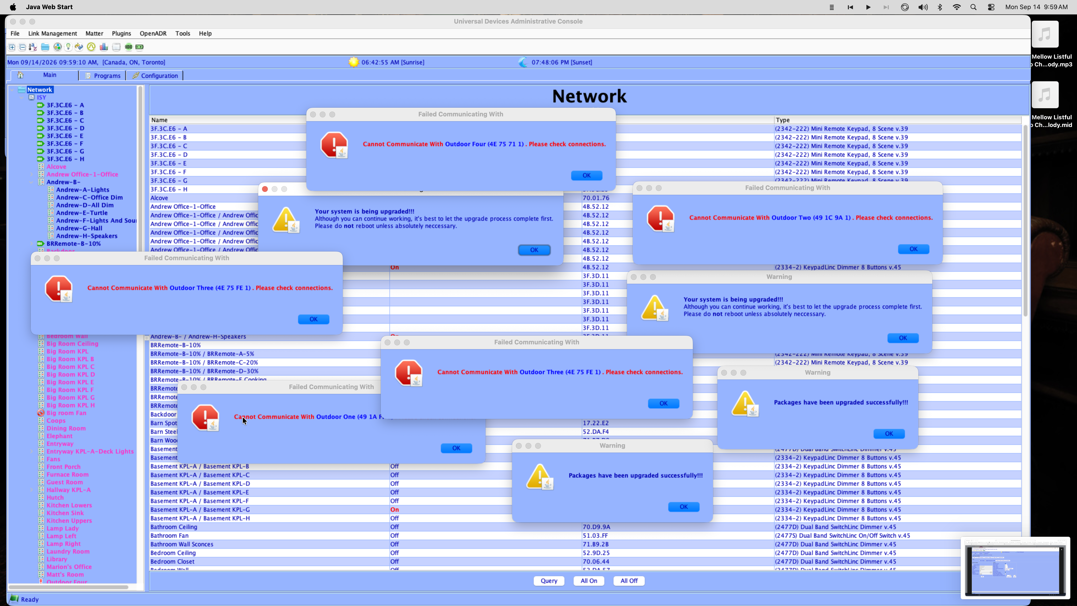

  7. I added this device a while ago but every time I open the GUI this window is still there. I'm not sure how to get rid of it

  23. They are all listed as scenes When I trigger the scene in the GUI the GUI says the light changed but in reality it hasnt Also, this keeps opening when I open the GUI
