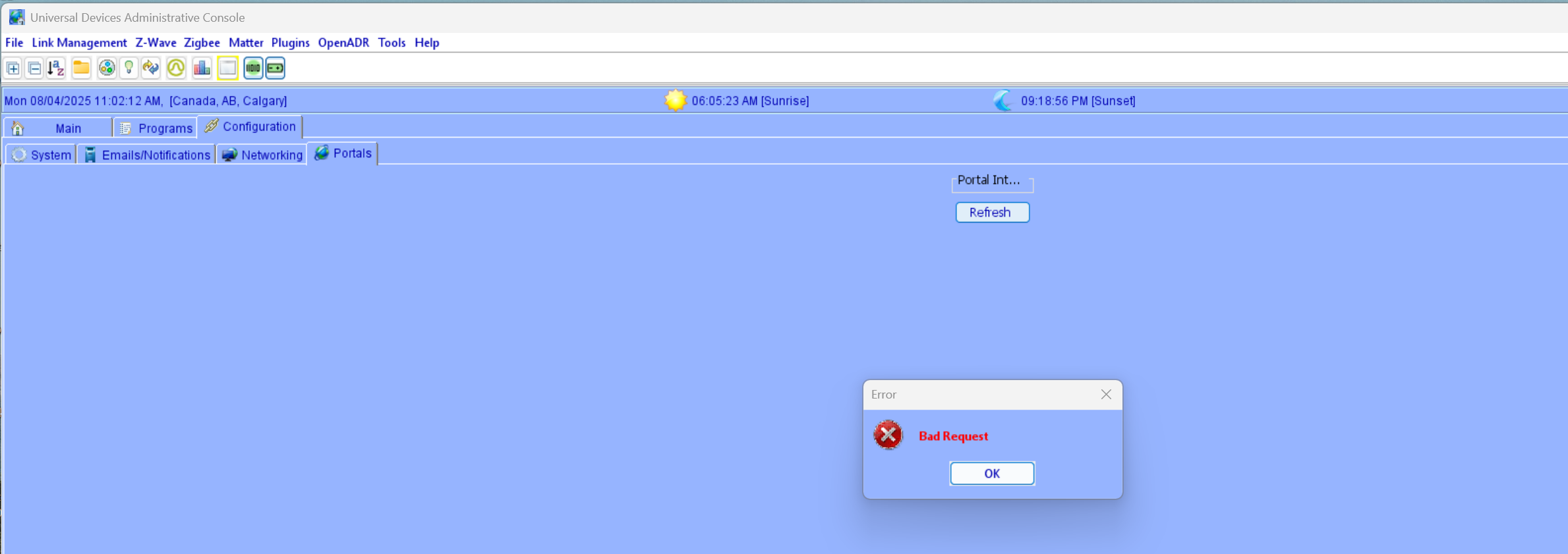

- And while trying to figure out what was happening with Portal I noticed this in the AC as well👇
Not the end of the world, but I'm curious to know if anyone else noticing this behavior?

Is the "other issue" the "Bad Request" on the Portal tab?
That is normal if you are using AC over port 8443 or 8080.

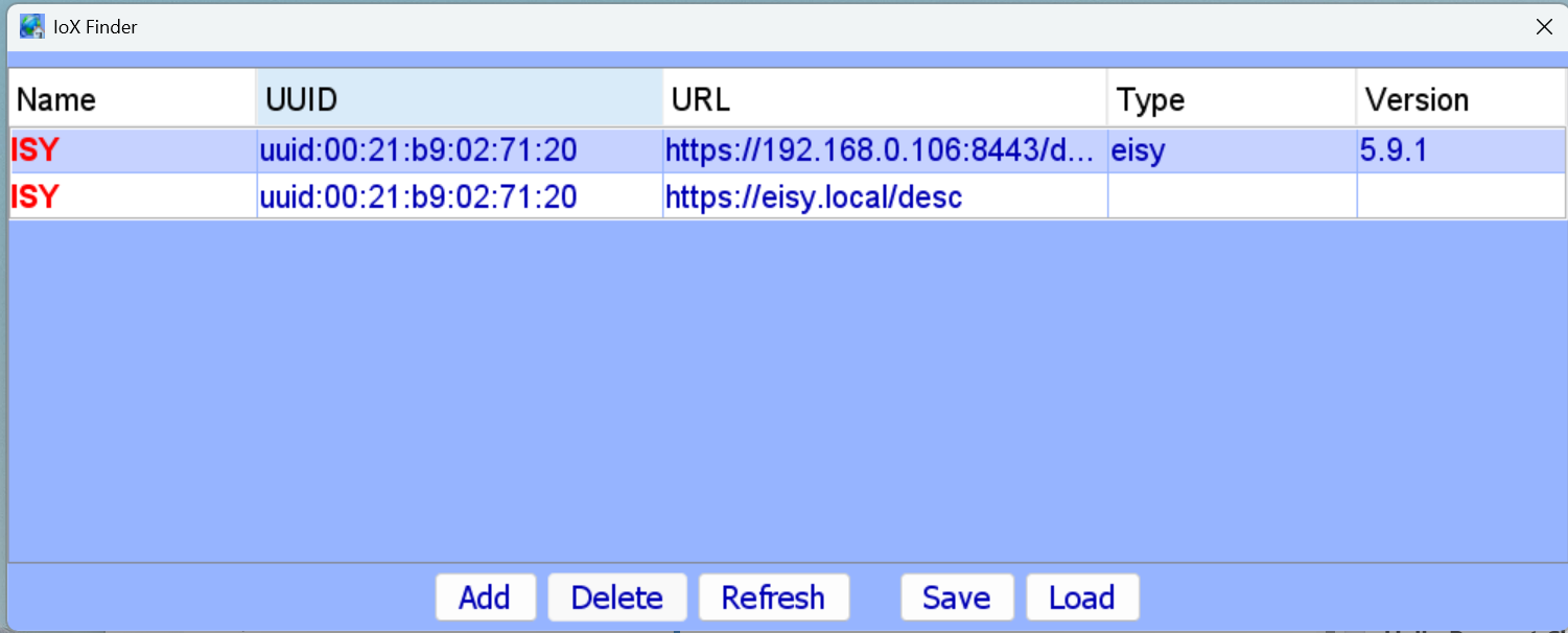

And Finder using https://eisy.local/desc doesn't work anymore - no popup for LAN, Cloud, PG3 when selected. Other login methods that include the IP work locally.

Yes. I understand it was working before. The difference is that you now have eisy-ui installed.
Explanation:
When eisy-ui is installed, it takes care of the connectivity to portal. IoX no longer does.
eisy-ui also takes care of the "portal approval" as it is tied to the portal connectivity. The approval process involves an exchange of tokens with portal through the proxy connection which IoX can no longer do.
So, when you are using AC and connect to IoX directly (8080 or 8443), the Portal tab won't work. If you use AC and connect to eisy-ui (no port specified), then the Portal tab will work just like before. Note that you can also manage the portal approval using eisy-ui's web interface.

The url works fine. This is what I see the in the Finder - looks incomplete.

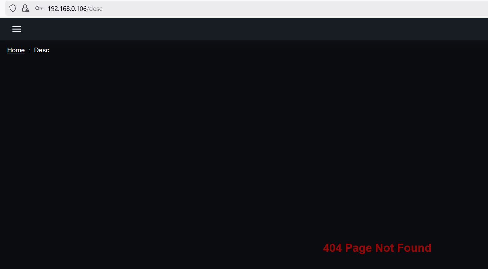

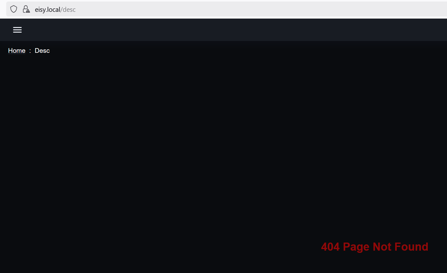

The line showing https://eisy.local/desc should show the type and version. The fact that it does not tells me there is a problem. Can you try the url in a browser? Does it respond at all?
Could you also try https://192.168.0.106/desc in admin console and browser? It it works, but https://eisy.local/desc does not, it could be explained by a dns resolution problem.
On 8/15/2025 at 11:13 AM, mmb said:
Hi @bmercier I don't think https://eisy.local/desc ever worked but https://eisy.local/ works fine.
I assumed it was the difference between the AC target and the web UI target.
The web ui responds on the root. /desc should return you the the same as :8443/desc
Can you please update eisy-ui, based on the logs, I can tell you are using a previous version of eisy-ui.

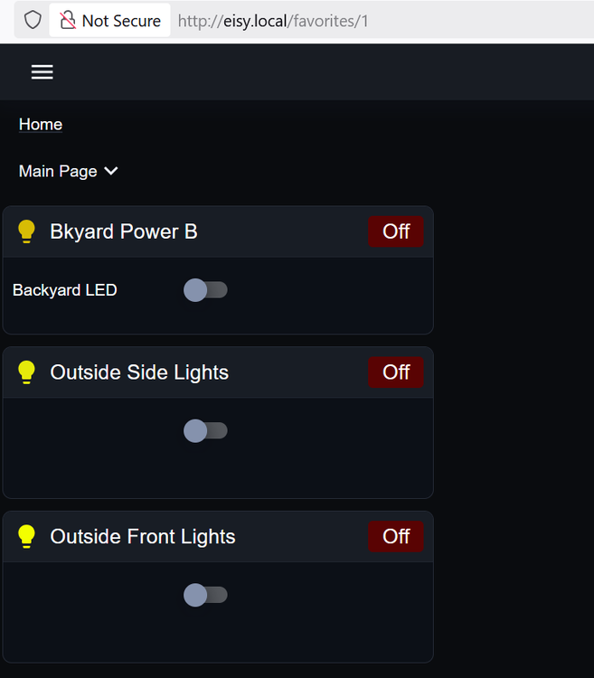

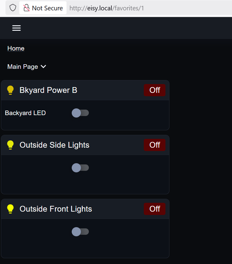

What's the result of http://eisy.local/desc
If you see a web page, and not XML data, please use Chrome, and us Shift + Click reload button. This will reload the page without using the cache.

This looks good now.
So entering this url in the IoX finder should work.

4 hours ago, bmercier said:
That should return an xml like in the screenshot. Finder uses that info.
Got it, all good thanks!
