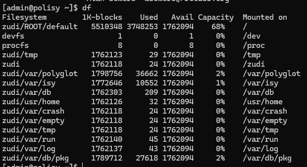

I installed the 14.1 polisy image and it formatted my drive with only a 3GB partition and left the rest of the drive unformatted.
If you do an image restore, I would definitely run the df command to confirm you haven't trapped yourself in a barely big enough partition.  I posted a link to a youtube video that shows you how to pretty quickly expand the partition if indeed you need to.
The 14.1 image is 5.9.1 and the older bsd version.  But after installing that image, fixing the partition size, I was able to update to 6.0.0 and the newer BSD just fine.
Looks like I got a small partition.  This is a 32GB SSD.
Everything is working, but not a lot of free space.  I'm going to check out the video.

@Michel Kohanim your image did get me going again, but I'm concerned about the disk image size.  Should I be?  Is there a reason that the total disk space is so much smaller than before, and the used amount (capacity) is so much higher?

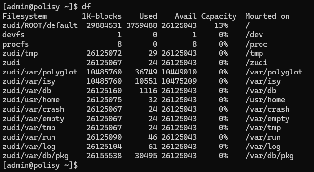

This worked for me exactly as posted in the video except for subbing in "zudi" for "zroot" starting at 1:06 in the video.  The screen shot for the video here is where the creator is typing zroot, you should be using zudi here and on the next line as well.

So this small filesystem size thing is popping up again. That's three of us now.
Yeah, looks like his drive was only partitioned with less than 6GB of space.  After the update, I was using a bit over 6GB, so that would definitely not work out.

Thanks.  I found your older post and just did this on my Polisy.  In addition to the zudi substitution, I had to "sudo" the autoexpand command.  It looks like it worked.
Two additional comments: I'm not sure the update packages that I ran after reimaging did much, if anything.  And it probably all fit in the 6G original partition because this is an empty Polisy.

After I flashed polisy to 5.9.1 I only had 3GB on my drive.  I didn't know it at the time because I never checked, did think I needed to.  I then tried upgrade packages and it bricked it.  Then when I put the drive back onto my windows PC I discovered that the partition was only 3GB.  I flashed it again, and once again, 3GB.  At this point I did the above youtube instruction and it expanded my partition to 120GB.  Then I did the "update packages" command, it worked correctly.  So my polisy is now on 6.0.0.
EDIT:  Of note, after it updated to 6.0.0, polisy was using roughly 6GB of drive space, so I suspect your previous update packages would not have had enough room.  Surprised it didn't brick like mine.
