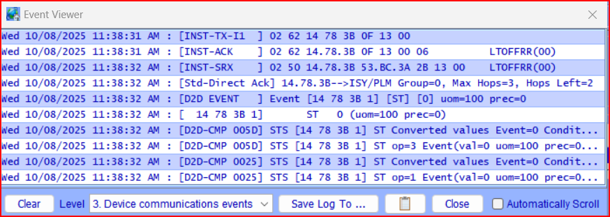

Can you try capturing a "Event Viewer" transmission when one of the random lights activates?  You'll need to have the viewer on Level 3 to see the transmission.  I understand that this may be difficult because of the randomness of the events.   The following is an event where my Home Assistant install instructs the ISY to turn off a basement light (using the Rest interface).  It's indistinguishable from a normal ISY command (I'm using a ISY994).  I'm hoping you have something similar going on - not noise, bad links, or a failing PLM.
If you can't seem to capture one of the events, you could try disabling your various plug-ins.  I really don't use them on my ISY994, so others will have to assist here.

Here is the event viewer capture level 3 for a recent random illumination event.
random actuation ISY-Events- Log.v6.0.0__Wed 2025.10.08 04.06.11 PM.txt

That appears to be rather damning.  Not sure what device 60.41.6b.1 is, but it is absolutely being turned on by a rest command (Alexa?).
I had seen other posts from users of the Eisy that showed "Rest" commands in the event viewer and was hoping yours would show the same.  My ISY994 does NOT indicate Rest commands.
Not a solution, but now you know where the command is originating from.  Hopefully you can drive to a solution with the help from others on the forum.
[comment: the following are the steps that initiated a random turn on of a light thru I3 switch 60.41.6B.1 ]
Wed 10/08/2025 03:56:57 PM : U7 Rest:  submitCmd([60 41 6B 1],[DOF],[<NULL>])
Wed 10/08/2025 04:04:15 PM : U7 Rest:  submitCmd([60 41 6B 1],[DON],[<NULL>])
Wed 10/08/2025 04:04:24 PM : [60 41 6B 1      ]            ST 255 (uom=100 prec=0)
       [comment: I initiated a "shut off light" command using Alexa plus spoken]
Wed 10/08/2025 04:05:07 PM : U7 Rest:  submitCmd([60 41 6B 1],[DOF],[<NULL>])
Wed 10/08/2025 04:05:07 PM : [60 41 6B 1      ]            ST   0 (uom=100 prec=0)

60.41.6B.1 is the address of the I3 switch for the light that is randomly coming on.  I'm beginning to believe my upgrade to the Alexa plus service, which is closely coincidental with these random lights might just be the source.  I am going to try to revert back to my less capable Alexa plug-in to see if that eliminates the spurious signals.  Alexa plus is still in the advanced development stage, and it might have some bugs.  Just guessing.
Others have been reporting issues with Alexa plus. Someone mentioned actually calling Amazon and canceling it, and things got back to normal.

Your earlier "Event Viewer" post showed that the EISY was receiving REST commands instructing it to turn on/off device  60.41.6B.
That is the EISY simply responding to an external command.  Not a fault of the EISY or the PLM.  It's a valid command that is being received through the network interface.

i will run my event viewer at night at some point and see if i can figure out “who” is to blame.
I have a comment for @IndyMike:  if I just go into the portal and remove a device from the Amazon echo list, does it instantly remove the echo/alexa control of that device?  I’m thinking not.  I’ve had many devices that have duplicates and many challenges with trying to remove these duplicate devices.
