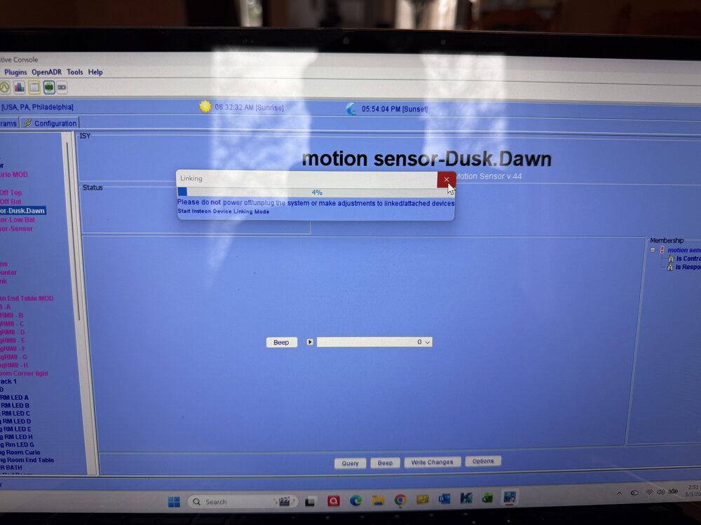

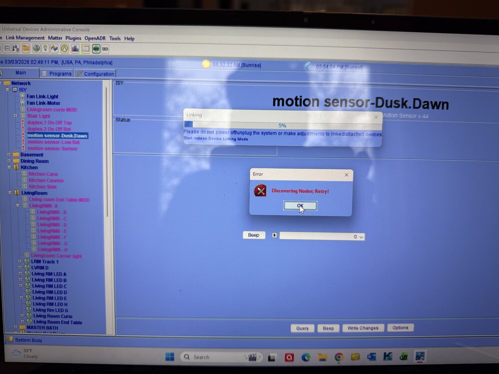

well seem all is well other then non of the 8 button keys swtchs, not working or talking
In iox, pick one of the keypads, right click and pick "Restore Device". Give it some time as keypads can have a lot of scene programming. Maybe pick one that is the least complex in terms of scenes.
Test that on again and see if it fixed it.
Pual I have'nt got it to work so I moved on to a light module . For some resason it does work either. When i staart up the console it keep going into linking for what ever reason. I feel so dumb. And yet I programed plcs
Ok. I wouldn't feel dumb, the migration is a significant upgrade and a lot has changed.
The next step would going into IOX, going to Tools/Diagnostics/Event Viewer. At the bottom of event viewer is a box for setting the level, set it to 3.
Then go through the moves of what you are trying to do, event viewer will capture the Insteon protocol at a detailed level. Post the results back here. I'm not the best at decyphering those but there are members here who are and will likely review it and come to a conclusion.
do you know how to do a factory reset. Im starting to think i made a mistake buy this upgrade. I cant even add a lamp module with out errors
