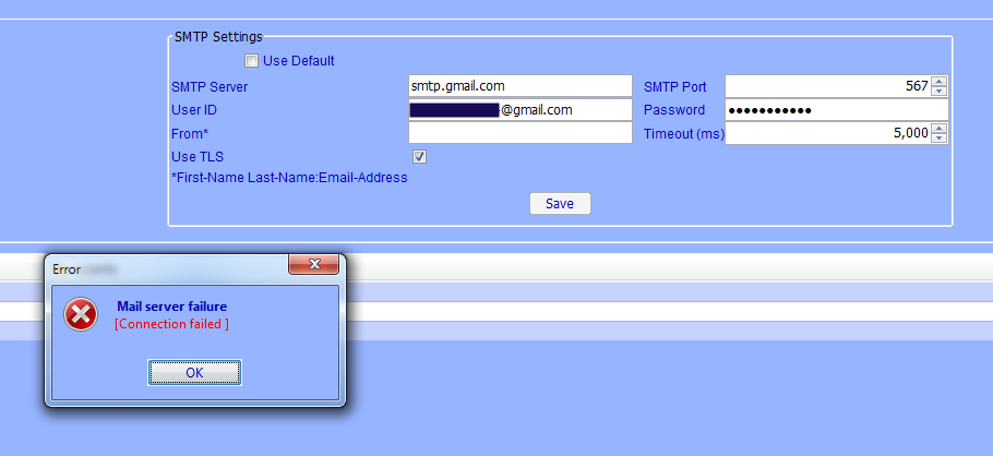

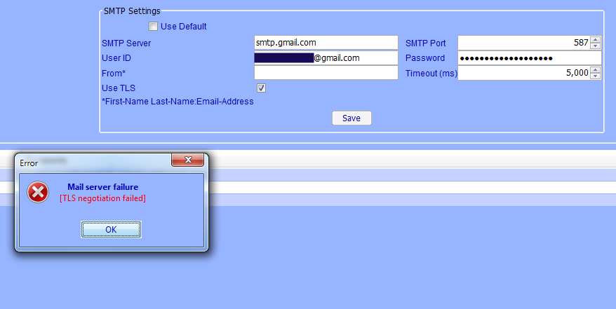

I notice a port error in that config, so I reset the passcode in the Gmail account fixed the mistake, and got s different error.
I just typed it in wrong in one of the many trials I ran.

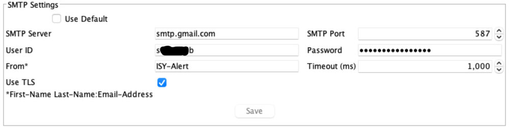

Edited by sdynak
I tried your method, but, alas, it did not work for me.
I tried the "Default" mail server and it works now! I will use that until I can resolve the Gmail issue.
I have put the question to the Google forums, so We will see if they know of a solution. I will let the thread know the results.
- Techowl -
@Techowl I havent been using the email option for a long time, but decided to try to set it up.
I followed the advice below and it worked immediately with the settings as shown above by @Ross
