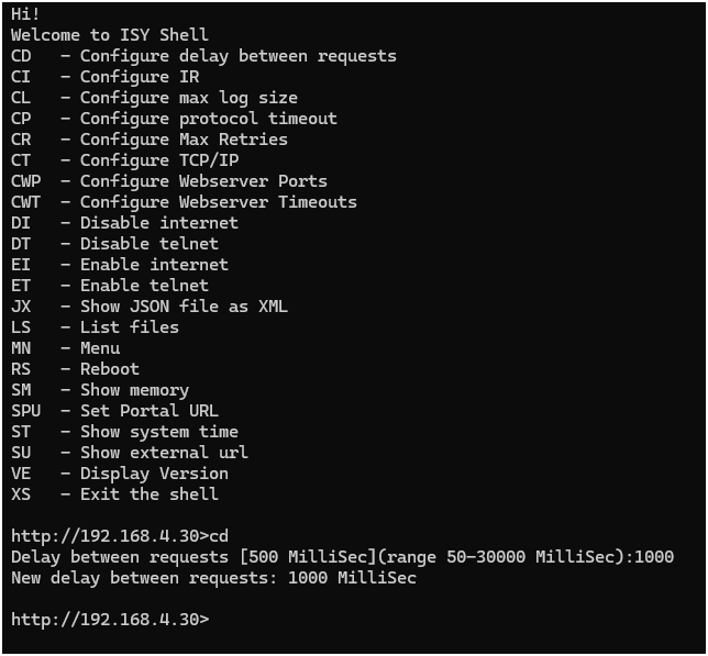

The ISY994 has a configuration shell that can be accessed through telnet. One of the items in the shell is a "CD" or "configure delay between requests. I interpret this to be a delay between successive requests to the PLM.
My ISY994 was originally set to a CD timing of 500mSec. I found this to be a very bad setting for my system. I have been using 1000 mSec for most of this year with good results.
My question is - does the PolISY or EISY have something similar to this timing feature? It can be extremely helpful in preventing overrunning the PLM when things don't go as planned.

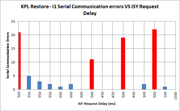

Yes - The following is a history of errors VS request delay for the restore of a KPL. The restore process requires ~800 I1 commands.
I tried increasing and decreasing delays. Also repeated delays multiple times and re-checked the 500 mSec because I couldn't believe what I was seeing. I don't understand why, but 500 mSec was the worst.

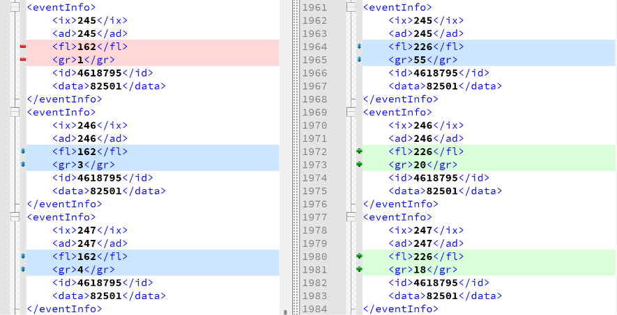

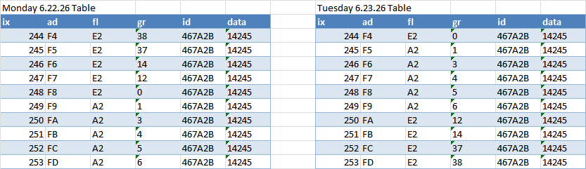

But, I did notice a difference in the PLM table. Same number of items, and the "id" three bytes, and the "data" two bytes are constant, but in a half dozen (of the 293 lines), the FL & GR values, which is the first two bytes, did change.
I am thinking that this is normal?

@oskrypuch , that actually doesn't look normal. I'm hoping that something simply moved around in the PLM. That could happen if you were adding/deleting scenes.
Would you mind posting your tables? I normally import to excel so I can see them in Hex.
@oskrypuch , it looks like all your data is there. For some reason it's been re-ordered.
The following shows the entries for your device @46.7A.2B. The column names correspond to the XML entries -
  1. ix - PLM record number (Dec)
  2. ad - PLM record number (Hex)
  3. fl - Flag (Hex). "E" = controller, "A" = Responder
  4. gr - Group # (Hex)
  5. id - Device address (Hex)
  6. data - Device specific data (on level, ramp rate, varies by device/scene)
It looks like your second table was re-written in "group ascending" order. I don't know why this was done. I spot checked a couple of other devices - they were not altered.
In any event, it looks like your PLM is managing to hold onto its data
