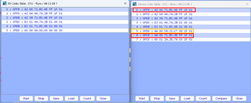

18 hours ago, oskrypuch said:
Poking around the link tables, here is a capture of the device and ISY tables for a given device, when it is not working correctly ...
And here it is, AFTER a device RESTORE (as per above) of that device (and return to functioning) ...
They match now, and it is the device that was changed, the last three entries were deleted, and a high water mark was added.
I don't know exactly what that means, but probably someone here can decode that.
Now, to see if the disparity in the tables (and loss of function) recurs.
We might be getting somewhere.
Orest
Your link table is a bit odd, but I don't see anything that would prevent the device from communicating with the PLM
Observations:
  1. Lines 1 and 6 (red) are responder link records for group 0 (normally the PLM) device @71.B3.6E. This is the link that allows your PLM to control the device. I've highlighted the links because they are essentially duplicates - this shouldn't happen.
  2. Line 5 is a responder link record for group 0 device @58.23.C7. This is another controller in your system that can control your device. Again it is not normal. If this device were to change the state of the device the PLM/ISY would probably Not know about it.
  3. Line 4 is the group 1 controller link to your PLM @71.B3.6E. Your device uses this link to communicated local changes back to the PLM/ISY.
  4. Line 3 is a group 1 controller link to device 46.7A.2B. When you turn on your local device it will communicate with this device.
  5. Line 2 is a group 4 responder link to device 46.7A.2B.
Bottom line, I don't see anything that would prevent this device from communicating with the PLM (unless the duplicate records are screwing things up).
Please determine what the controller device @58.23.C7 is. This may be a "leftover" from your old PLM.
Link tables don't get written to unless you ASK the ISY to write them. Link tables ARE modified when changing device backlighting and adjusting scene settings. If you have programs that modify either, you may with to disable them to troubleshoot.
If you find your link tables again being modified, please post back.

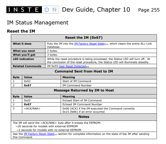

@oskrypuch , not what I expected, but your PLM is definitely being reset due to a communication error with the ISY
Observations:
  1. You have a mind numbing amount of communication to two devices that I believe are thermostats (11.B2.60 and 0E.67.7F). you appear to be requesting temperature data from each of these every few seconds. That's 12 send/receive communications in 5 seconds and it repeats roughly every 30 seconds. In 2 hours and 4 minutes you had over 5K send/receive comms or roughly 1 every 1.4 seconds.
  2. Your communications to the devices are excellent. 96% of your communication with the two devices was received with 3 hops remaining. It doesn't get much better than that.
  3. You did have 2 communication errors between the ISY and the PLM. The PLM will normally echo a serial command back to the ISY. Sometimes the echo is incorrect. You had two of these. We've seen rare cases where these can cause the dreaded "All-on". The errors in your log appeared innocuous at first. When I looked closer, a communication to the PLM was interpreted as a "Reset Modem" command.
  4. You also had two serial communication timeout errors. This is where the ISY sends a command and the PLM does not echo it back. My scanning routine declares a timeout if nothing is received back within 10 seconds, or if xx commands have been executed.
The following snippet from your event viewer log shows 4 normal ISY to PLM exchanges. The ACK is the PLM acknowledging the transmission. The 5th exchange is corrupted. The PLM appears to have byte shifted the ISY command. It believes the ISY is requesting a Modem Reset
10269 Sat 06/20/2026 12:40:04 PM : [INST-TX-I1 ] 02 62 0E 67 7F 0F F0 E8
10271 Sat 06/20/2026 12:40:04 PM : [INST-ACK ] 02 62 0E 67 7F 0F F0 E8 06 (E8)
10277 Sat 06/20/2026 12:40:04 PM : [INST-TX-I1 ] 02 62 0E 67 7F 0F 6A 00
10279 Sat 06/20/2026 12:40:04 PM : [INST-ACK ] 02 62 0E 67 7F 0F 6A 00 06 (00)
10285 Sat 06/20/2026 12:40:04 PM : [INST-TX-I1 ] 02 62 0E 67 7F 0F 6B 02
10287 Sat 06/20/2026 12:40:04 PM : [INST-ACK ] 02 62 0E 67 7F 0F 6B 02 06 (02)
10293 Sat 06/20/2026 12:40:05 PM : [INST-TX-I1 ] 02 62 0E 67 7F 0F F0 49
10295 Sat 06/20/2026 12:40:05 PM : [INST-ACK ] 02 62 0E 67 7F 0F F0 49 06 (49)
10301 Sat 06/20/2026 12:40:05 PM : [INST-TX-I1 ] 02 62 0E 67 7F 0F 6A 20
10303 Sat 06/20/2026 12:40:08 PM : [RST-ACK ] 02 67 06
My 1st suggestion would be to reduce the number of queries to your thermostat by a factor of at least 100. Temperatures simply don't change that fast.
Currently thinking through other workarounds.

@oskrypuch , I have to give credit to @kclenden . Some time ago he opened my eyes to the fact that ISY to PLM errors are occurring. I have been monitoring them on my system with the ISY994.
To date I have seen 1 verified instance of a "All-on" caused by a communication error. Yours was the 1st instance of a communication error causing a PLM reset. I had not previously conceived of that.
I would say that cutting down on the fast repetitive communication would definitely help reduce the issue. Bottom line, if you didn't have issues prior to the program modification, that's most likely your answer.
As a go forward, I would recommend a full PLM restore followed by individual device restores. The PLM log that you posted only contained 8 devices.
