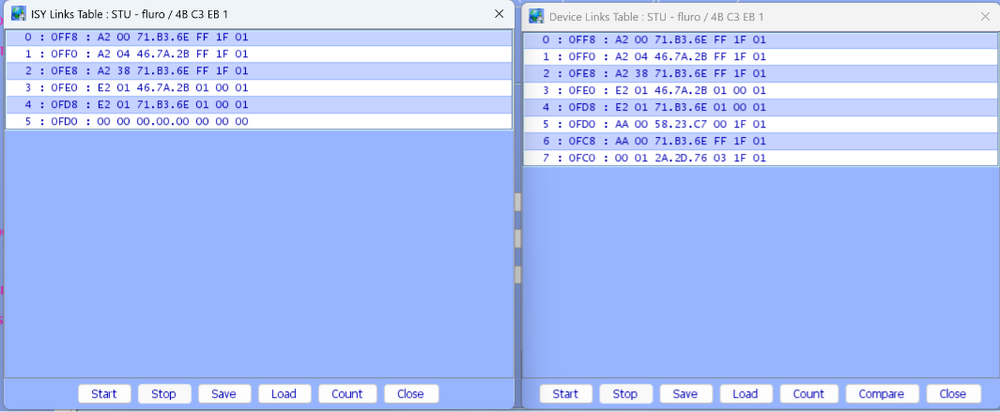

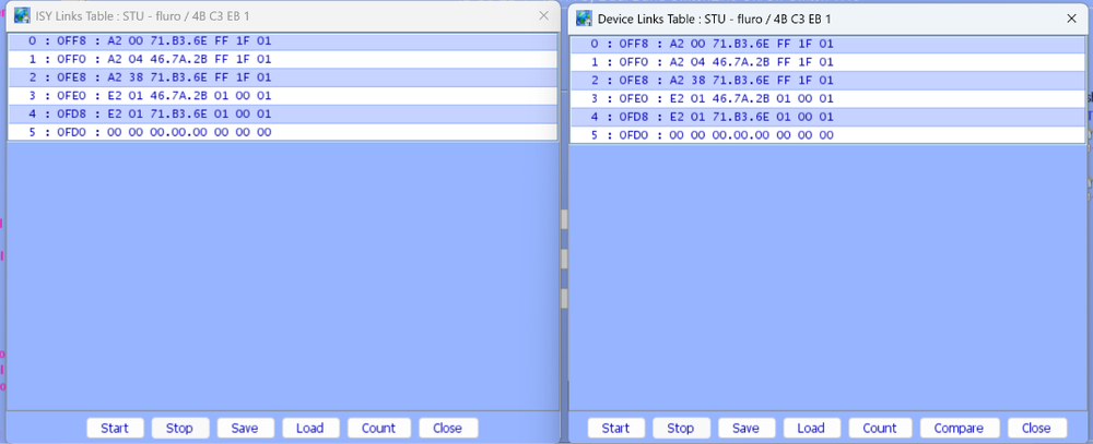

Yesterday at 06:13 PM1 day I have recovered from this, I think, but can't be certain there still aren't some issues. I am wondering if there is something more I should do, like certain diagnostic steps, or even potentially replace the PLM.In some 15 yrs of ops, have never seen quite this kind of failure.The SystemSystem is large, 100+ devices, mostly insteon, a bit of zwave (700 series dongle), polisy running "LTS" 5.4.4. Zwave was added during the time of insteon troubles. Stuck at 5.4.4 as the polisy OS won't support further upgrades, and the bit of Zwave now complicates a move (reflash/restore etc.), so been sitting on it for a bit.The ProblemOne morning I noticed that ALL of my wireless insteon devices stopped working (ISY would not see any transmits), that includes the 2842 motions, the newer 2844 motions, and the mini two & four key 2432 remotes.But, in addition a number of the 2334 eight/six button units would also not be seen by the ISY. Curiously, scenes that toggled the state of the buttons on these, still functioned. (so ISY saw no TX, but units accepted RX)Zwave devices not affected.In the UI, no device showed as not responding, or any indication of offline status, except that the wireless devices' pages showed blank fields, that is no ON or OFF status, etc., and not able to QUERY or change settings.The was no "nine blink" indication on the motion devices (indicating network connection loss), nor the "three blink" showing low battery.What I DidScratched my head for while, checked the diagnostic screens, nothing obvious to me.Then on a lark, starting with the simplest thing, I put one of the wireless devices in link mode, and did a simple RESTORE DEVICE command. I saw the usual activity dialogs, and then amazingly, the device started working normally!I then tried this with one of the 2334 eight button panels, that restored its function as well.I went through each of the devices (that I know faulted), and did the same. They all started working.The QuestionHow did this happen? Do I need to do anything more?Were all of the wireless devices, or matching tables in the PLM, somehow selectively memory corrupted? But, what about the eight button panels too?Is the PLM starting to fail. Certainly I've seen random devices fall off for control when that happened in the past, but never such a logically grouped set of devices, nor could I restore function as easily. With the device restores the system seems to be back up and running. Pretty sure the PLM is newer version, with the updated capacitors.Thoughts??Orest Edited yesterday at 06:25 PM1 day by oskrypuch
Yesterday at 06:27 PM1 day Congrats, you win the odd-one-of-the-week award!Initially I was thinking rf noise, but reading through it all, it would appear that the PLM memory got partially corrupted. If, as you seem to be saying, wireless devices were still able to trigger actions in other devices (as part of scenes) but nothing was seen at the ISY, it seems that links would have somehow been lost in the PLM. If I had suspected this, I would have started with a restore of the PLM. Of course, hindsight is always easier, and I might be totally off here.
Yesterday at 06:52 PM1 day Author Yes, I was thinking the same, an odd one!I am suspecting the PLM, but so odd to have such a specific grouping of devices all fail at the same time. Maybe some sort of "logic wave" that went through the system, and it affected only certain kinds of devices. A stretch I know.I was going to try the PLM refresh, but it takes a bit of time, so thought why not -- try the simple device restore first. I would expect that restores the device's entries in the PLM tables, besides the device itself.Maybe I should still do a PLM refresh, to catch things I haven't noticed yet. Orest Edited yesterday at 06:53 PM1 day by oskrypuch
Yesterday at 07:36 PM1 day Author Spoke too soon!Same failure, again.So perhaps a PLM refresh, and if that doesn't work (or maybe just do it as I have spares), a PLM replacement/refresh.Orest Edited yesterday at 07:36 PM1 day by oskrypuch
Yesterday at 07:51 PM1 day Author Oh dear, last 2413S I have (v2.5) I have it marked with tape saying "bad?".And they don't sell serial PLMs any more.Need to go USB modem, so that means I remove the current serial cable, and just plug the USB cable in directly?Orest Edited yesterday at 07:58 PM1 day by oskrypuch

10 hours ago10 hr Author @auger66 Well, I think you are in the "interlude", at the moment. 😉I would suggest, if you have a recurrence, buy a new PLM and carefully do the full the replacement procedure. (as per above)OTOH, if it doesn't recur soon, if you have an older PLM (pre v2.4 or so), just get a new PLM anyway, and have it in inventory for the future.I have ordered a new 2413U, should be here in a couple of days, and will report back. For now my smart house, is semi-dumb!It seems that the fault state, affects any device where the system expects to hear from it with a Tx. Obviously that includes wireless motions, remotes and water detectors, but that also includes the 6/8 button panels and similar. And the fact that a device restore (temporarily) corrected the issue, to me strongly suggests it is a hardware rather than logic/software issue.All points to the PLM, the usual weak link.Orest Edited 5 hours ago5 hr by oskrypuch
