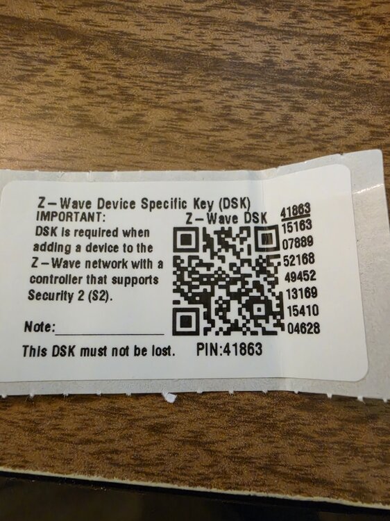

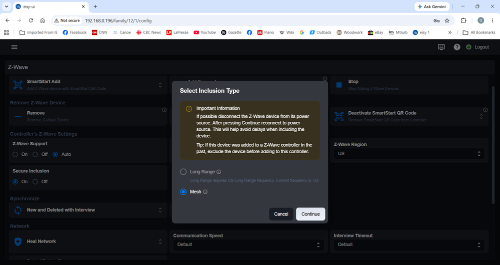

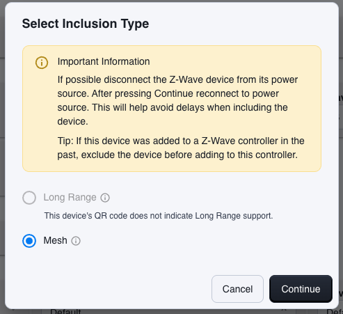

6 hours ago6 hr On 9/28/2026 at 4:23 PM, Javi said:Yes we locked out z-wave long range unless at a min version (7.42) as other version had too many issues. eisy-ui is currently the only interface which gives you the option to choose mesh or long-range.Tip: take a picture of the QR code and upload to pc, then select the image instead of trying to scan with a PC camera.... or use eisy-ui on mobile@Javi which version of eisy-ui has the LR capabilites?
