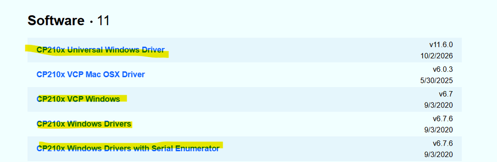

Easy enough process to unplug from EISY, then install windows driver, plug into usb port, then web updater) but I am wondering if this is common practice or if many others are doing this step

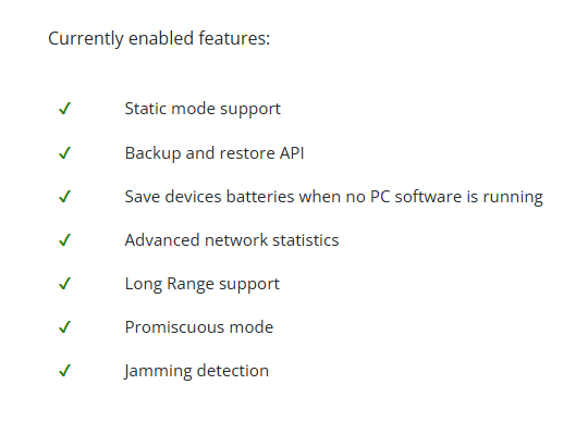

Also under more options I see some available options such as long range
Currently enabled features:
Static mode support
Backup and restore API
Save devices batteries when no PC software is running
Advanced network statistics
Promiscuous mode
Jamming detection
You hardware additionally supports:
Free
Long Range support
Add this feature
Free
UART communications on faster speed
Add this feature
99
Zniffer and Advanced Radio Tool
Add this feature
Maximal power (+7 dBm)
Upon request
Change vendor ID in Serial API
Upon request
