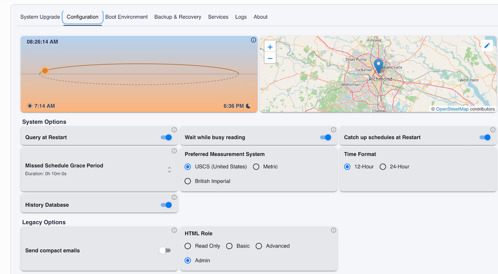

Perhaps that's coming in a near release? I'm using the latest beta eisy-ui (1.4.2), and there is a Configuration Option under the System Settings that allows specification of location and display of time.

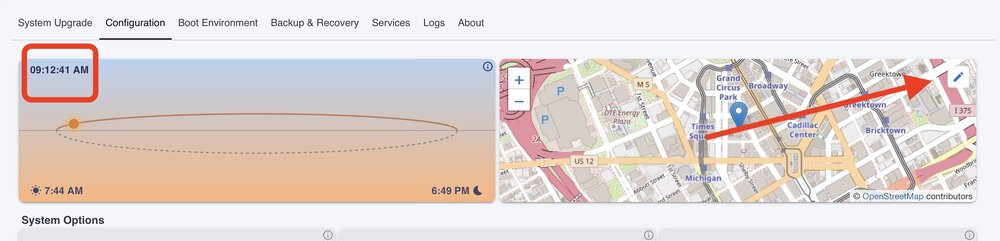

In eisy ui, go to System, Configuration and you will see a map on the upper right and a time display picture on the upper left. If it is wrong, follow the next steps.

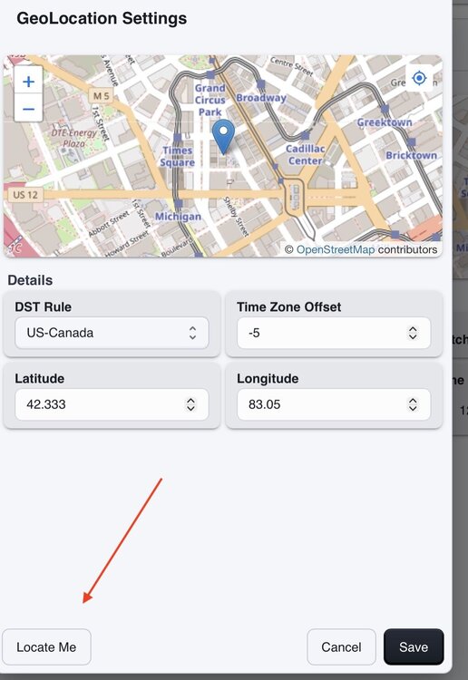

If you click on the pencil for edit on the upper right it will open a box where on the lower left you can select LOCATE ME. This will open another box with cities and time zones. Select the one that is correct and then back you way out by hitting save and then the tie on the upper left should display correctly.
I have had trouble with manually adjusting the time and it sticking. And when I actually locate myself on the map, the GMT offset is incorrect.

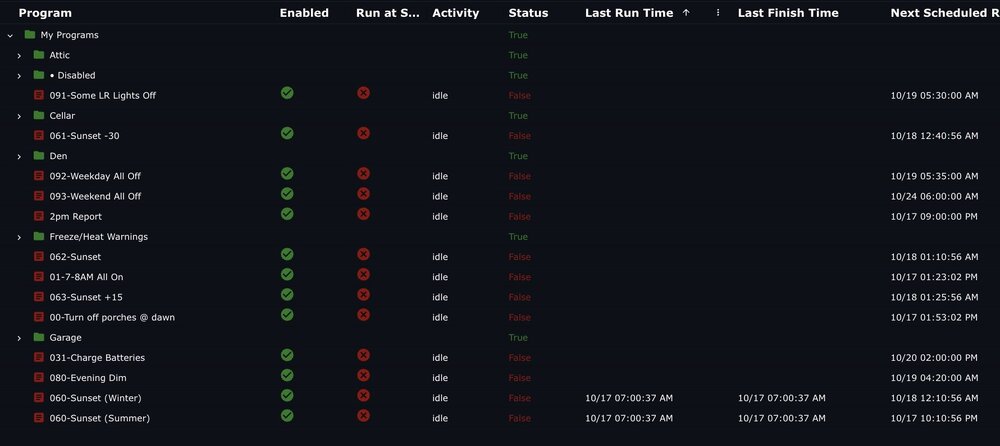

I opened a different browser (Safari instead of Brave); I also tried incognito mode without success. I can access an iMac at home (CDT -0500) and the display is clearly different from the MacBook Pro (CET +0200). But I cannot make sense of them (they were taken as nearly simultaneously as I was able):
Remote machine (CET +0200):
Home machine (CDT -0500):
Edited by GHenry
Added simultaneity; corrected time zones

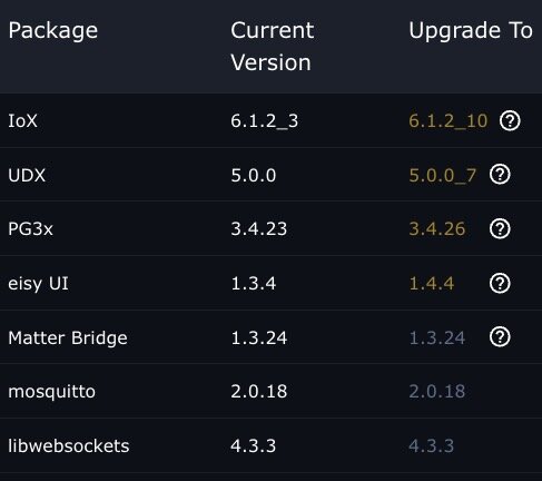

What is your firmware (iox/udx) versions? If not on the latest production firmware this could be related to a bug in a previous beta/staging Just want to be sure we are both looking at the same firmware.
I'm extremely cautious about upgrading remotely…Murphy's law! I've also tried changing the URL to v1.4.4 of eisy-ui. And BTW, the lights were on again at 03.00 presumed eisy time.
Edited by GHenry
Added URL version change, lights on

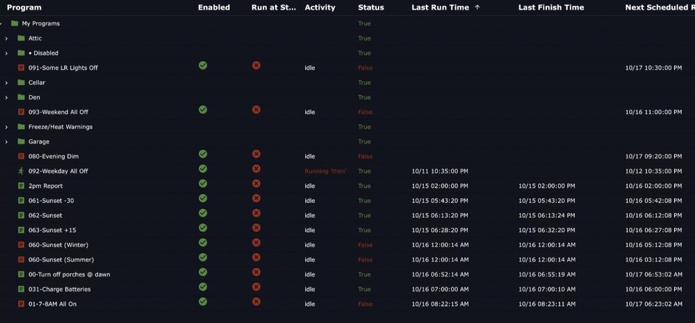

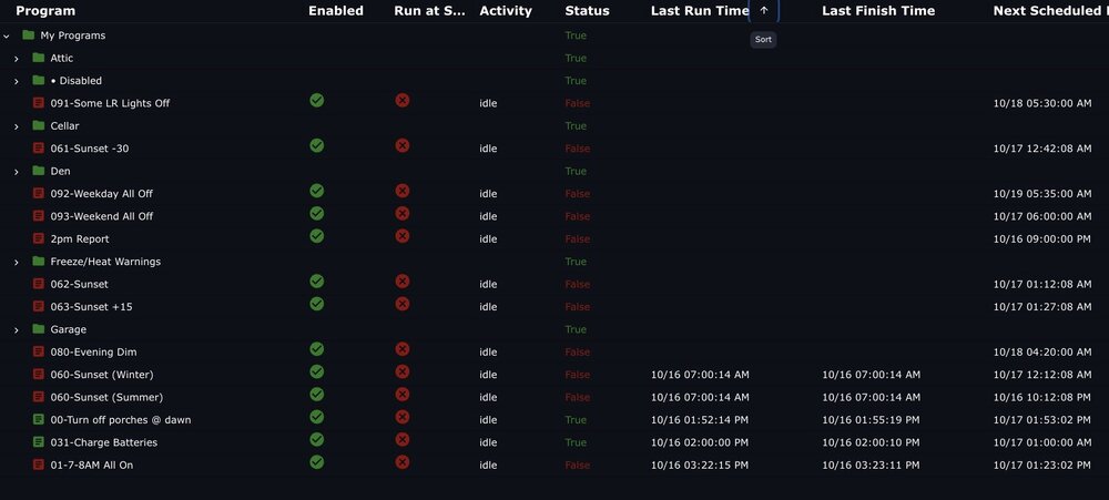

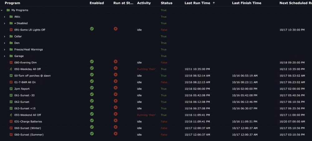

I took these screenshots as near to the same time as I could. What explains the differences in last run, next run, and last finish times? First one is CET -0100 (named it wrong, daylight time!):
second is CDT +0600
Ok I am almost sure Beta 6.1.2_3 had the time issue. There are a few topics on the forum. I think @apostolakisl reported the issue, but I'm having a difficult time finding the forum topics.
With regards to eisy-ui version the URL must match the eisy-ui version installed, if not it could have strange behaviour.
This is not a major upgrade, but It is always safest to do when on location.
