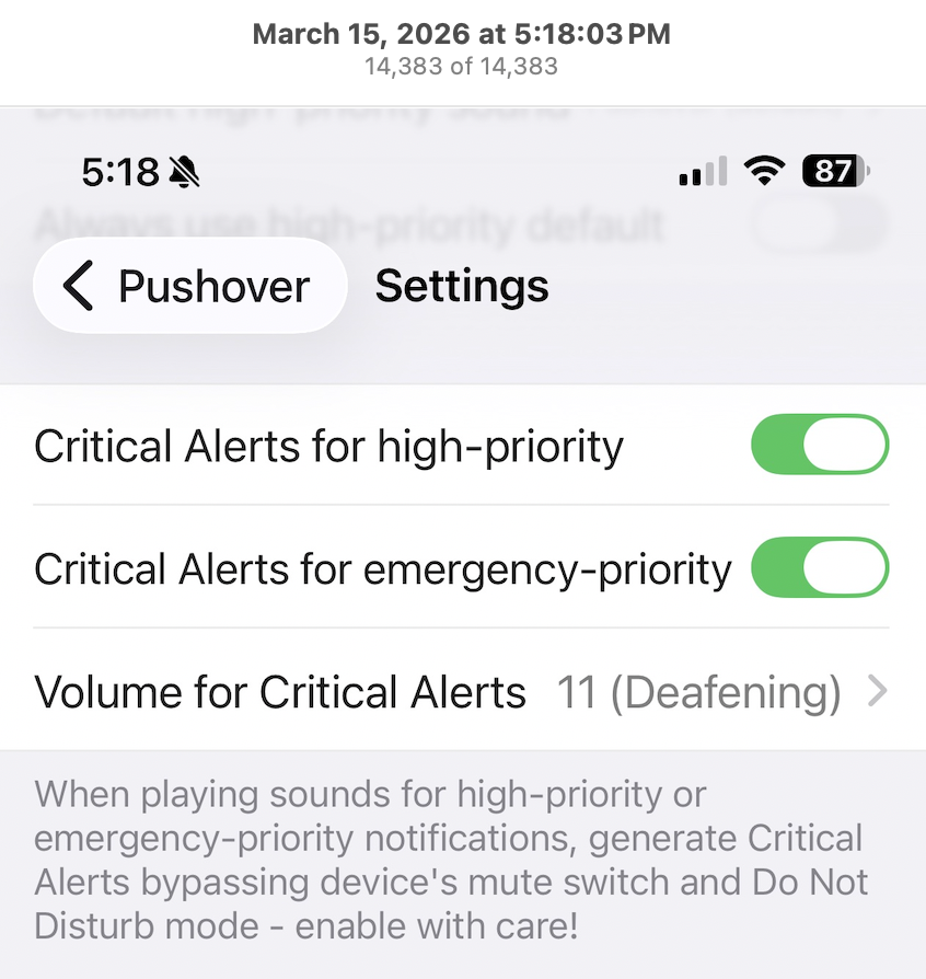

  2. Hi Paul, You nailed it again. In the Pushover app there is a setting for enabling the Critical Alerts for Emergency which apparently are #2. I enabled this and have the red alert now and the sound comes through. Honestly, never knew the volume was adjustable on Critical alerts. If this doesn't get my attention, my wife's or anyone around us on the deafening setting if there is a smoke or CO alert nothing will. So in summary.. you need to add the "retry" & "expiry" settings as well as ensure the Pushover app is enabled for Emergency Alerts. I changed the 60 seconds to 30. That seemed like the minimum. I tried 20 and under and it failed. I do see these settings on the Pushover site and not sure how I missed it before. Thanks for your guidance and all you do here as always! You could have saved a life or my pets (2 birds & 2 dogs) in the future. Best, Stan

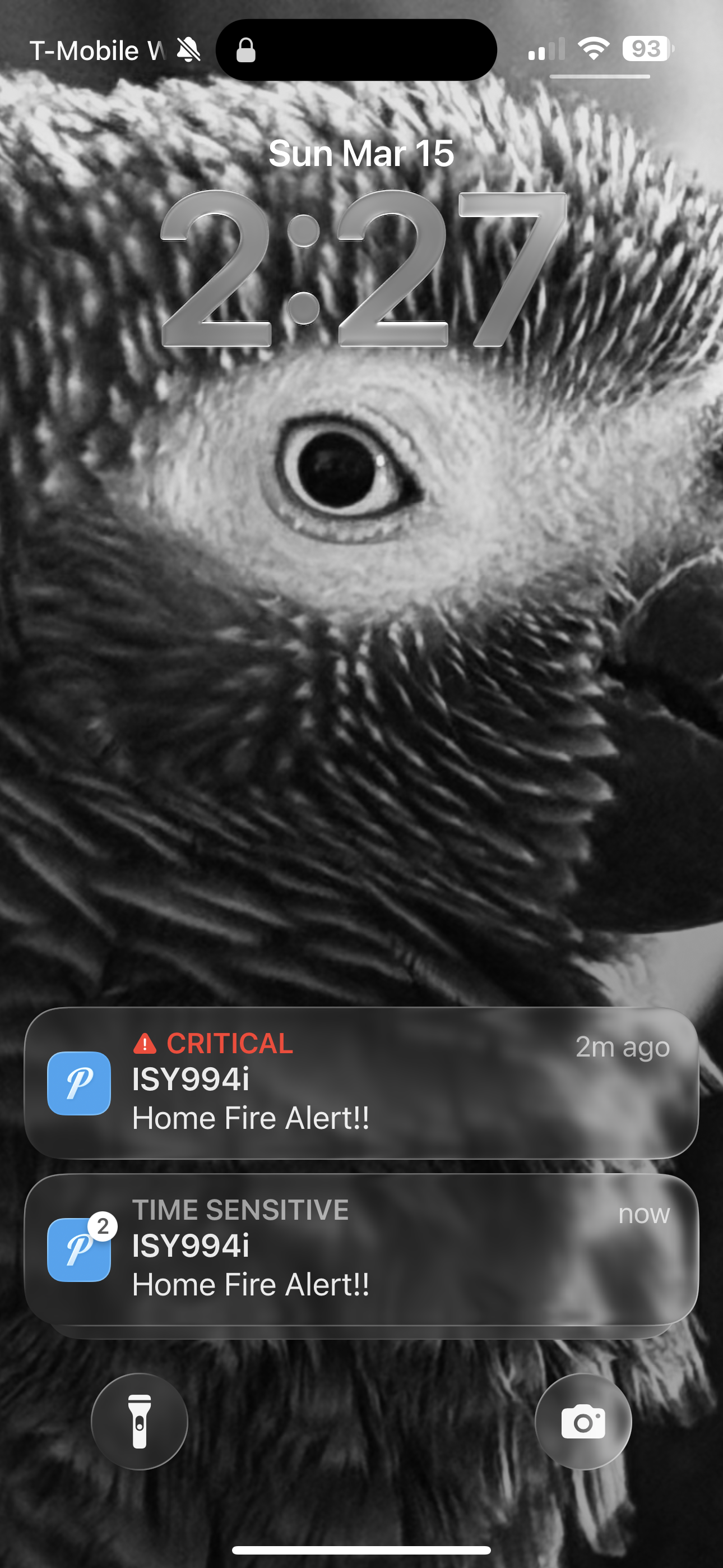

  4. Thanks Paul.. Although I don't get an error when including those changes now I lose the sound and the alert changes to time sensitive losing the red exclamation. Here is a screenshot of my home screen showing both the priority 1 in red and the priority 2 that looks plain. I'm not as concerned as the exclamation but no alert tone bypass would be an issue. I did try changing orders like putting the sound right after priority and after the retry/expire and didn't seem to change that. Here is my last test line: token=XXXX(replaced for forum)&user=XXXX(replaced for forum)&priority=2&retry=60&expire=3600&sound=persistent&device=Stan_iphone&message=Home Fire Alert!!

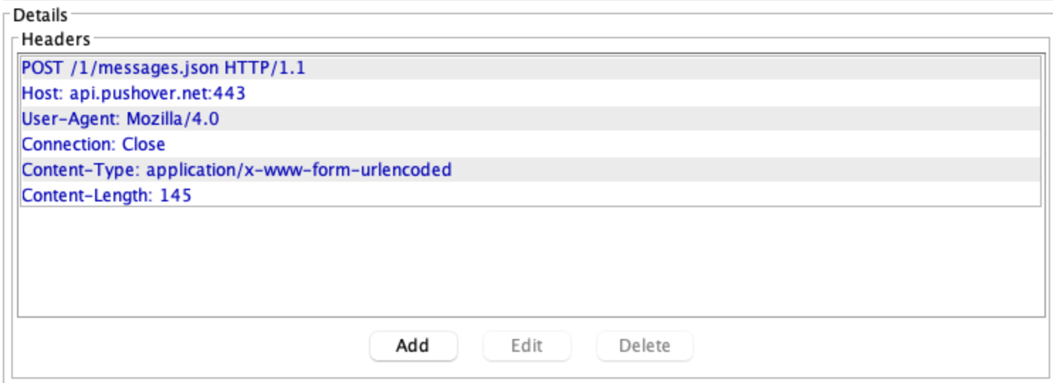

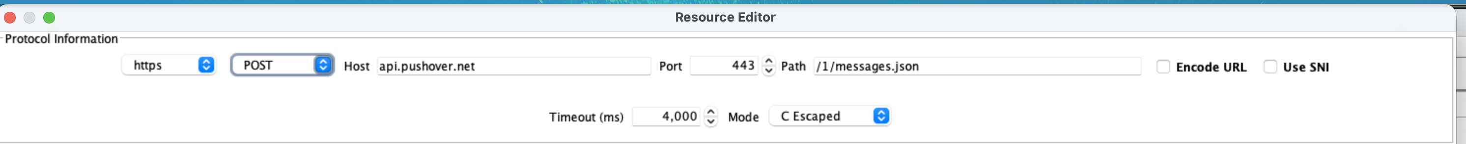

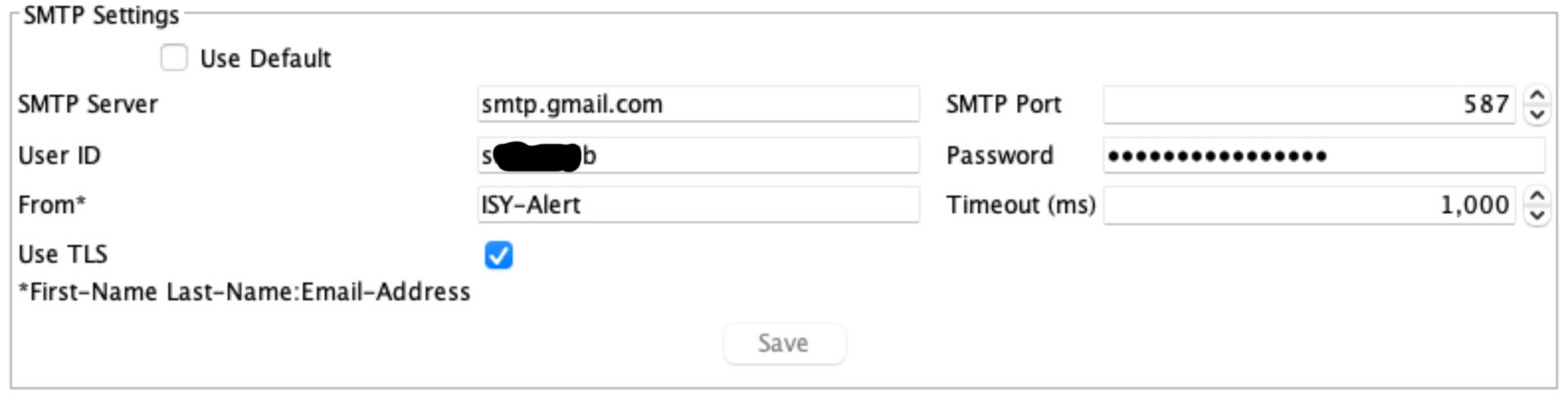

  5. Hi Paul.. Apologies for any confusion.. I made assumptions based on my use of Pushover as I only use it with network resources for Pushover alerts on my iPhone. The screen capture is a result running a test for the network resource. I don't know how resource uses the Pushover backend such as the email error that is displayed. I am doing this on my ISY and was not sure what other section would be more suitable but happy to move it there if there is a better place to create it. It will work fine until I change the priority to 2. Config in Network Resources: POST /1/messages.json HTTP/1.1 Host: api.pushover.net:443 User-Agent: Mozilla/4.0 Connection: Close Content-Type: application/x-www-form-urlencoded Content-Length: 145 token=XXXX(replaced from actual)&user=XXXX(replaced from actual)&priority=1&sound=persistent&device=Stan_iphone&message=Home Fire Alert!!

  9. Ok, I'm not familiar with the Gmail workspace and if it functions the same. Are you using a "App Password" for Gmail? I believe you need this to make it work as a more secure environment. Not sure that will work with your domain setup. You could always just try a standard Gmail account and test. This could help also -
  10. Doesn't the user need to be a gmail account or did you not update the SMTP server settings? Seems you are using a gmail SMTP but a ID for sandbergweb.com.
