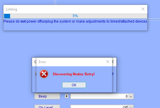

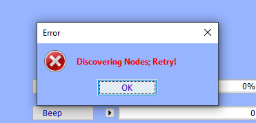

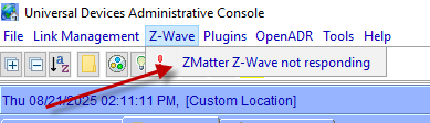

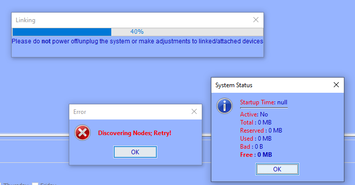

A few weeks ago, some of my zwave shades stopped opening and closing. Then some of my insteon devices stopped working. Now when I test them in the Admin Console, they don't work. Then now, I get the box popup saying Linking (with a % scale) stays on my screen. Goes to 100% and then starts over. It never stops. Then I whet to Tools >> Logs Errors saying Discovering Nodes; Retry! and I can't get rid of that error. I tried again to see the logs and it asked me to view in excel. The logs are blank.
What is going on and how do I get out of this mess?

The "version"  in your admin console is blank and it shouldn't be
What controller are you using and what is its firmware version
Try clearing your java cache, be sure to check all 3 boxes, then download the IoX Launcher from here:
https://isy.universal-devices.com/start.jnlp
Also try removing power from the controller for about 30 seconds
@EddieRock you're probably best off getting help directly from UD on this issue.
Please open a support ticket with them:  https://www.universal-devices.com/my-tickets
Try what @Techman points out, but don't do anything deeper than that unless instructed to by UD. It's almost like something is corrupt and they would be best to work with to troubleshoot the issue and correctly resolve if it's more involved than simply reloading the IoX Launcher process or rebooting the eisy.
Ok. I've opened a support ticket. Michel Kohanim replied and had me pull my PLM for 1 minute. Then plug it back in and reboot my EISY with the power button "reboot eisy: press/hold power button-> red. Click again -> blue."
After the reboot, it wanted me to do an upgrade. I did.
All seems better now. Michel indicated that he thinks my PLM may be starting to fail. It's like 15 years old or so... I maybe dying...
