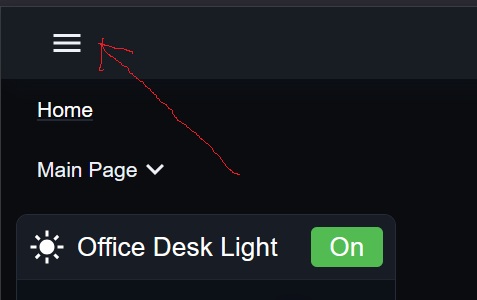

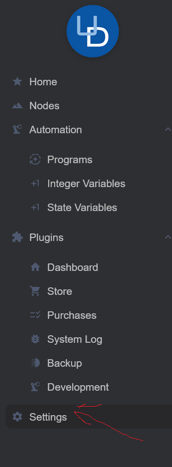

Main Menu (upper left corner):
Then Settings:

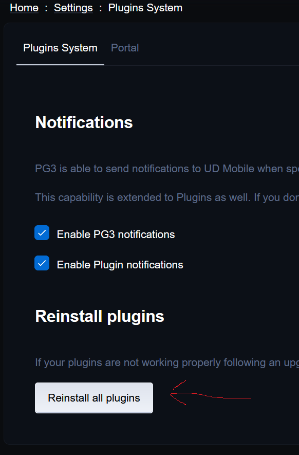

Then Reinstall Plugins:
Right! Think I did this yesterday, now after trying it again... no change.

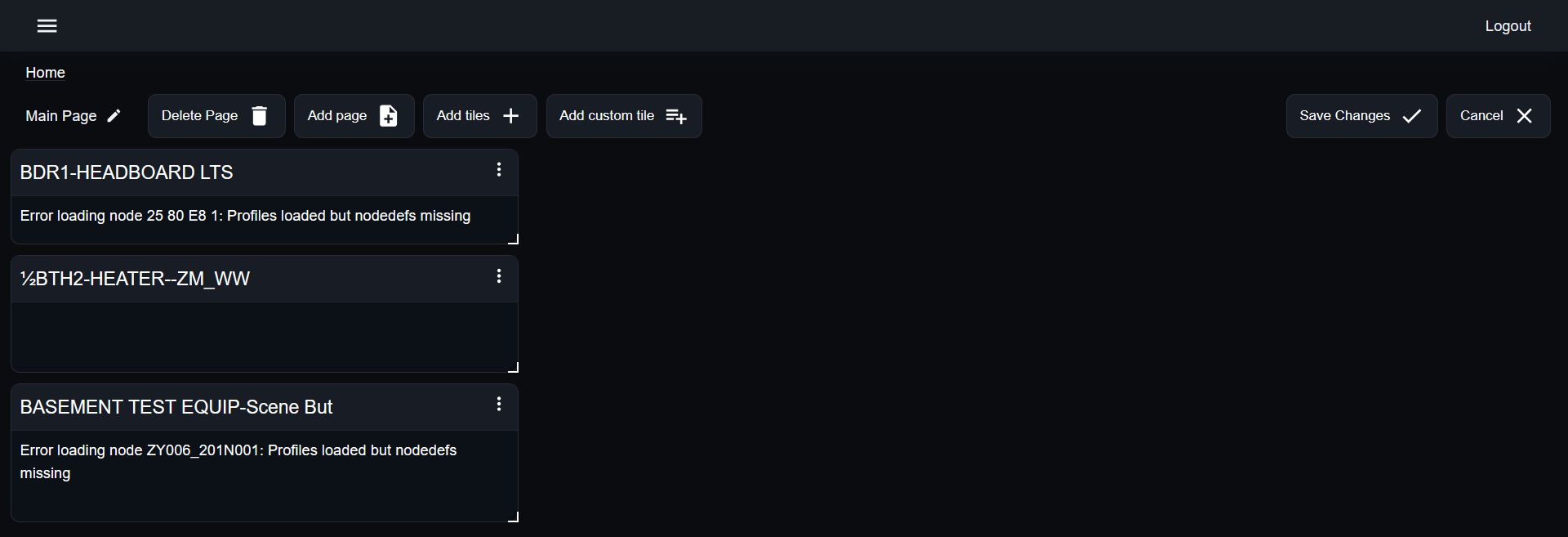

@woodchip from what I see here, there is a problem with nodedefs. You should open a ticket and include the screenshot.
Also please include the output of:
/rest/nodes
/rest/profiles?include=nodedefs,editors,linkdefs
/rest/nodes
I will follow your suggestion and open a ticket. Where do I find/access the outputs you suggest I include in ticket? Tks.
