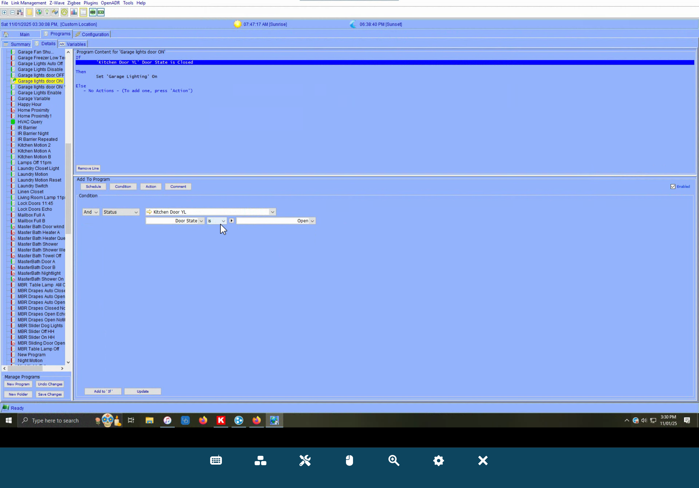

Can’t set correct door state in program
Replacing a door sensor from Insteon with one from Yolink. Noticed in program I can set “Door State” to “Closed” but can’t set it to “Open”. “Open” is a choice in the drop down it just stays “closed”, doesn’t apply it.

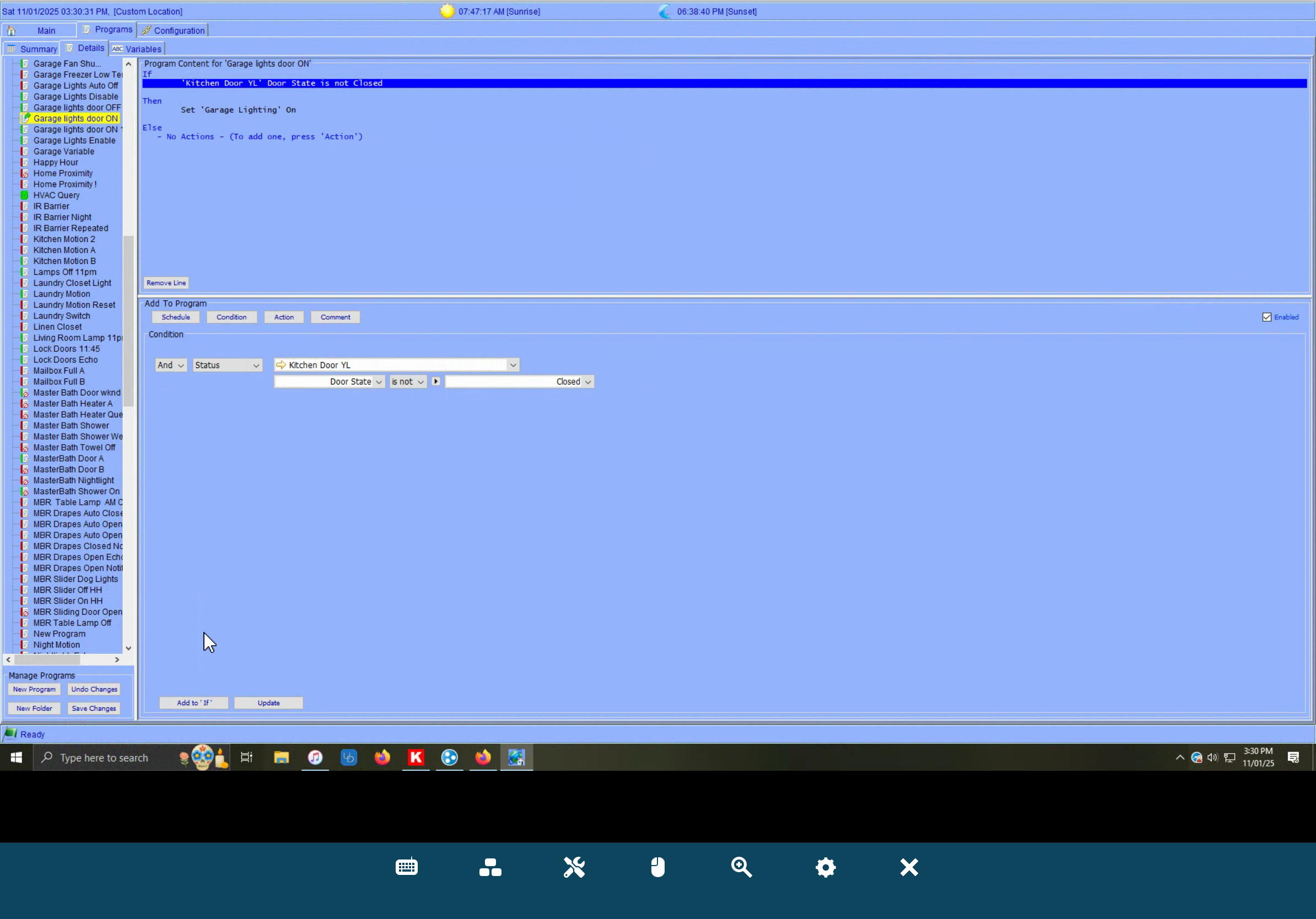

I set the line to “Door state is not closed” which works well just wondering about this.

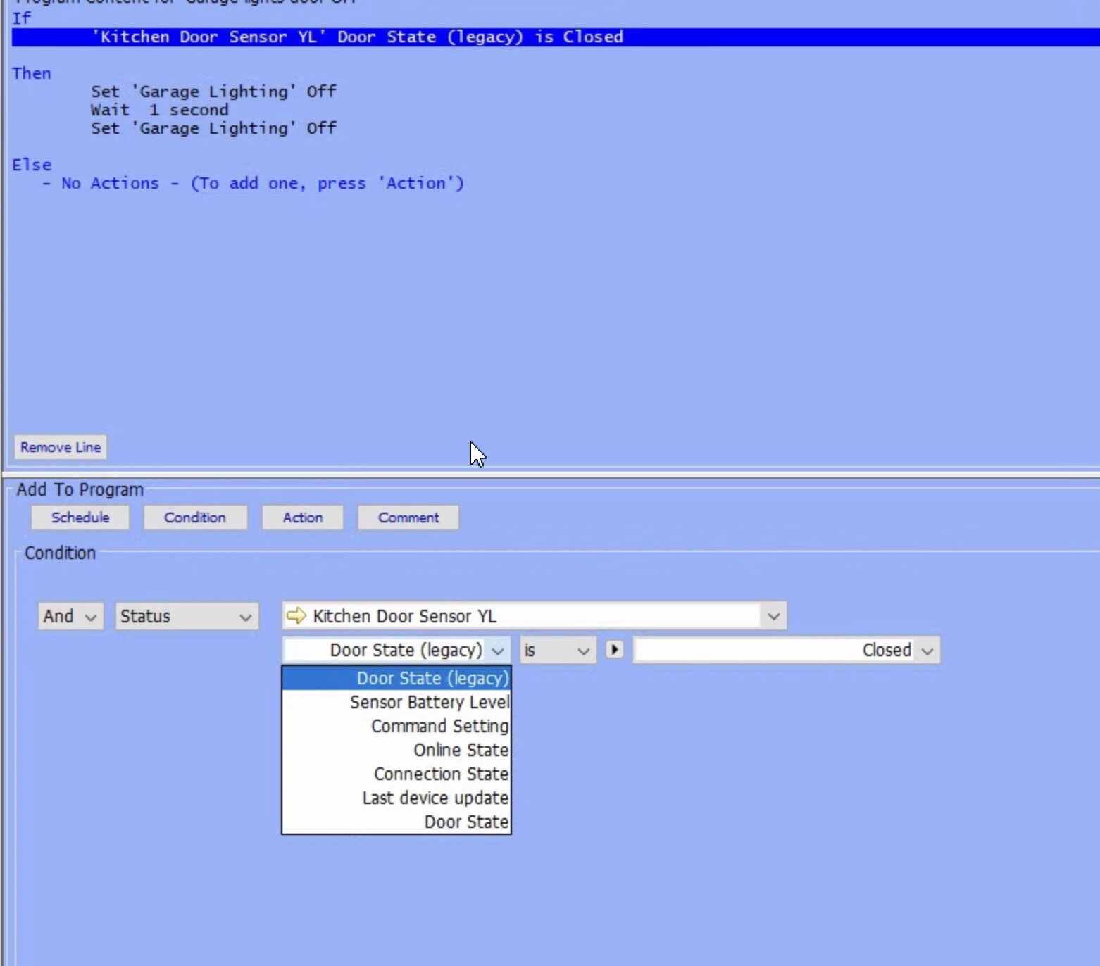

Ok - I think we found the issue - minor bug in AC (and partially my fault) - Issue occurred when I moved key parameter to ST variable (to show status in UDmobile). I left the original value variable with the same name(to ensure existing programs would still work, but AC cannot handle two variable with same name in the same node - I updated the variable names so ST (shows in UDmobile) gets the original name, and I appended a (legacy) to the name of the original variable. It should not affect existing programs as it updates automatically, but I would suggest moving to the ST parameter (without legacy) when creating/editing/modifying programs
Let me know if the issue is fixed in 1.6.10 - refresh store if it does not show yet

Updated and now have xx(legacy) as drop down option of status in devices
Ie. In programming Door sensors status has options for “Door status” and “Door status (legacy). Motion sensors have options for “motion status” and “motion status (legacy)….Same with vibration sensors
