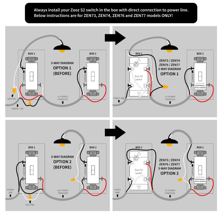

@TomNow2 , I'm a bit late to the party and I'm confused by the delay that you are seeing with the Zooz switches. Zooz is one of the few manufacturers that allows you to combine their Z-wave switch/dimmer with a conventional mechanical switch. It's one of the reasons I've installed them.
In my experience, the Zooz direct wire is far faster (immediate), 100% reliable, and far less expensive than the Insteon "virtual" 3-way.
The Zooz direct wire install (below) should be immediate. You mentioned "slave" switches - I assume these are simple mechanical switches. There should not be any interaction with the hub. If actuating the mechanical switch doesn't produce an immediate response in the load, you may have a ramp rate or something else programmed in the Z-wave switch.

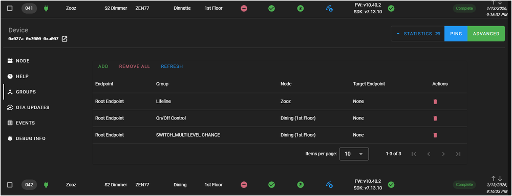

@TomNow2 , managed to learn a few things (or re-learn) about direct association. It's been a few years since I last tried it. It was a little painful, but in the end it worked well.
  1. As I mentioned above, OTA firmware updates will absolutely break associations. Bit me again - caused me to use some bad words.
  2. Devices being associated MUST have the same security level - Bite #2.
  3. Certain Zooz devices cannot be used without a load. The ZEN76 and ZEN77 dimmers apparently use current sensing as part of their dimming scheme - totally fouls things up when used without a load - Bite #3. Bad word usage again. Your ZEN72 dimmers are listed as no load compatible. https://www.support.zboxhub.com/kb/article/1737-how-to-use-zooz-switches-without-a-load/
  4. Devices must have the same security level - this part I managed to remember.
  5. In the end I was able to associate a ZEN77 load connected dimmer with - a ZEN71 switch (on/off), ZEN32 scene controller (On/off, Bright/Dim), and a ZEN77 load connected dimmer (On/Off, Bright/Dim). All devices operated seamlessly with very little delay.
  6. Associations for the ZEN77 shown in the graphic below. This is a Home Assistant presentation - hopefully it will translate to Hubitat. The Lifeline association is from the switch to the Hub (all units should have this). The On/Off and Multilevel change associations are required to give "Insteon like" On/Off and dimming control. This actually worked far better than I remembered. There may have been improvements since I last tried things.

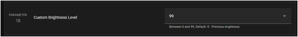

  7. Target device On level settings - Things didn't seem to synch well until I set the target to 100% on level in settings. Default was previous brightnessimage.png
Notes -
  • the Zen77 devices were using security level S0. This may speed things up.
  • Using two slaves would present far more associations and settings variables. This is where UD's Insteon scene setting shine. They've made things very easy for us.
  • I have no experience with Hubitat. Not sure if there are limitations there.
Bottom line - it was far more work getting the z-wave direct association working than anything I've used with the ISY994/Insteon. Once setup, it worked very well and was very responsive.
