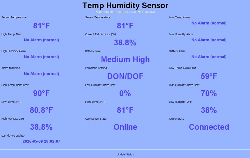

May 10May 10 I installed the .50 update this morning and immediately when from 18 nodes to 43. So far everything looks back to normal. Thank you for the fix.SS
May 10May 10 Looking good so far - thank you for the hard work on this. My various Temp sensors are correctly reporting humidity again. I haven't check the one motion sensor yet.
