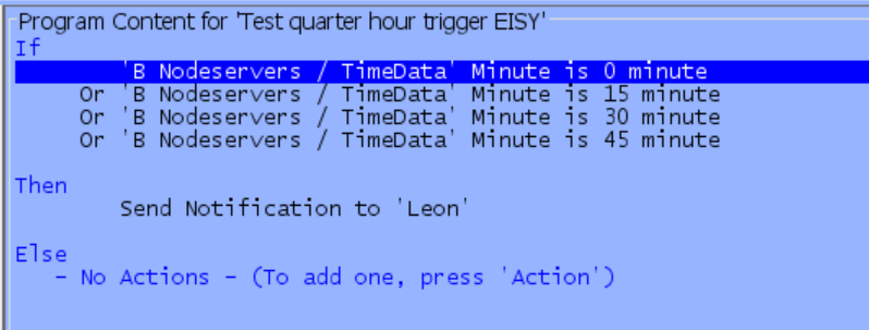

16 hours ago16 hr Hi All,I did a big upgrade on my EISY to latest everything about two weeks ago. I had to do a flash upgrade and forgot to backup PG3 separately. No big deal, just reinstalled and configured the nodes. Everything seems to be working OK except on one specific set of programs. These programs use the TimeData Minute to trigger them because they run several times an hour at a specific minute of the hour.These programs no longer run the "THEN" statement but only runs the ELSE statement. I created a fresh, new program, kept it simple, and it doesn't trigger THEN either. Is anyone else experiencing anything similar or any suggestions?IoX: 6.0.5PG3: 3.4.18TimeData: 3.4.0I have gone through multiple hardware reboots of the EISY. All the plugins were reinstalled in the same slot. There are no reported errors in the TimeData logs.Test program: (if I run "Then" directly, I get the notice, so that is working) Edited 15 hours ago15 hr by LFMc clarity

8 hours ago8 hr @LFMc the best way to share a program in the forums is to right click on the program and select "Copy to Clipboard". Then paste as text in your topic. This will give an easy to read format and make it easy for anybody helping to edit the program without too much typing.Looks like the post above you used "export". Be sure you select the last option of "COPY to clipboard". Screenshots aren't much help because people will have to retype a lot of stuff or try to describe what to do based on the picture. Also, the text becomes searchable on the forums if you should ever need to refresh your memory or have a similar issue you can find the "old" post based on the program information.
8 hours ago8 hr Author 30 minutes ago, Geddy said:Looks like the post above you used "export". Be sure you select the last option of "COPY to clipboard".My bad, I did export to clipboard. Here is the copy version:Test TimeData Min on EISY Month Copy - [ID 0117][Parent 00C8]If 'B Nodeservers / TimeData' Year is 2026 Then Send Notification to 'Leon' Else Set 'Active Devices / Study Track Lights' On Wait 5 seconds Set 'Active Devices / Study Track Lights' Off Edited 8 hours ago8 hr by LFMc
