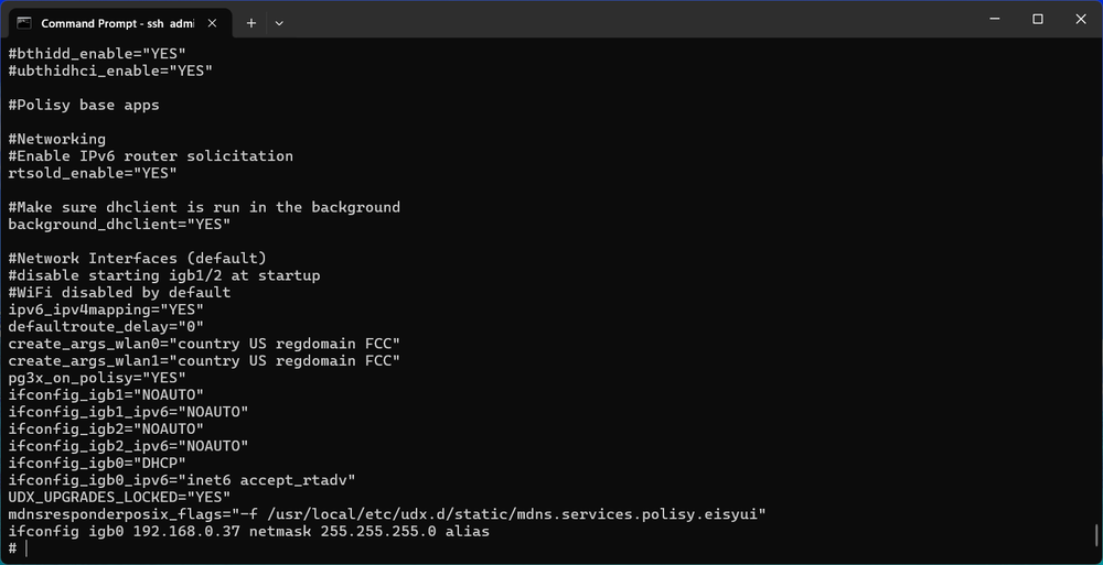

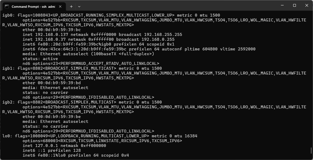

June 11Jun 11 Well I've been trying stuff on one of my test Polisys (I tell you, they really get used), and I just might have a workaround (not a fix) for you. This could also be a nice hack for those who for whatever reason might want a fixed IP address and can't do it with a DHCP reservation. You gotta be ok with going into your controller with ssh to do this.FreeBSD allows you to set more than one IP address for a network interface. The idea here is to let DHCP do it's thing, which keeps UDI happy because the correct default gateway, nameserver, etc settings are acquired. Then you define a second IP address that can be static, as an alias. It only takes one line added to the /etc/rc.conf file. The line is (for a eisy) "ifconfig re0 <fixed IP address> netmask <netmask> alias". The terminating "alias" is of utmost importance! For whatever reason it is suggested that the netmask be different than the default one, so I made it smaller. Here is what the line looks like in my /etc/rc.conf file. Note that this is a Polisy, so the network interface is "igb0" instead of "re0". The last several lines a somewhat different on a eisy.The reserved DHCP IP address for this Polisy is 192.168.0.137, so I made the fixed one 192.168.0.37 to keep it simple. My router's DHCP range is .100 and up.Now if you look at your network configuration with the ifconfig command, you see both addresses, like this:I manually added a new entry in IoX Finder to show the new IP address. It looks like two separate controllers, but with the same UUID.I tested it with admin console, going into PG3, and eisy-ui. All work fine, even after a reboot. An IoX upgrade might delete the added line so you could need to add it back if that happens.Let me know if you or someone else tries this.

June 30Jun 30 Author On 6/16/2026 at 5:56 PM, Guy Lavoie said:Tried it?Sorry for the long time. Life got in the way😁 So I did 3 things:Added more IP Addresses to my dynamic rangeChanged the assigned address to the last address in the new range ( so nothing else would have used that address in the past)Followed you process to add the alias addressSince I did that, the DHCP assigned address has not changed. But i also now have a second address that is hard coded and is working well. I actually am usingthe alias now for almost all my coding and access to EISYThanks for this suggestion Guy! I like it.
June 30Jun 30 Great! This will make others happy, the question of a user assigned IP address comes up every now and then.Remember though: that added line in your /etc/rc.conf file can get removed by a version upgrade, so be ready to add it back if that happens.
