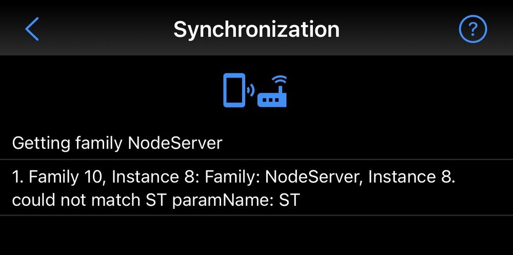

@Panda88 , after updating to IoX 6.0 and synchronizing UD Mobile, I received an error for Node Server 7 which is Yolink on my system. Please see attached screenshot.

I am still looking for the ST issue - I have not identified where it happens and there is not much in the error from UDmobile -I'll keep looking

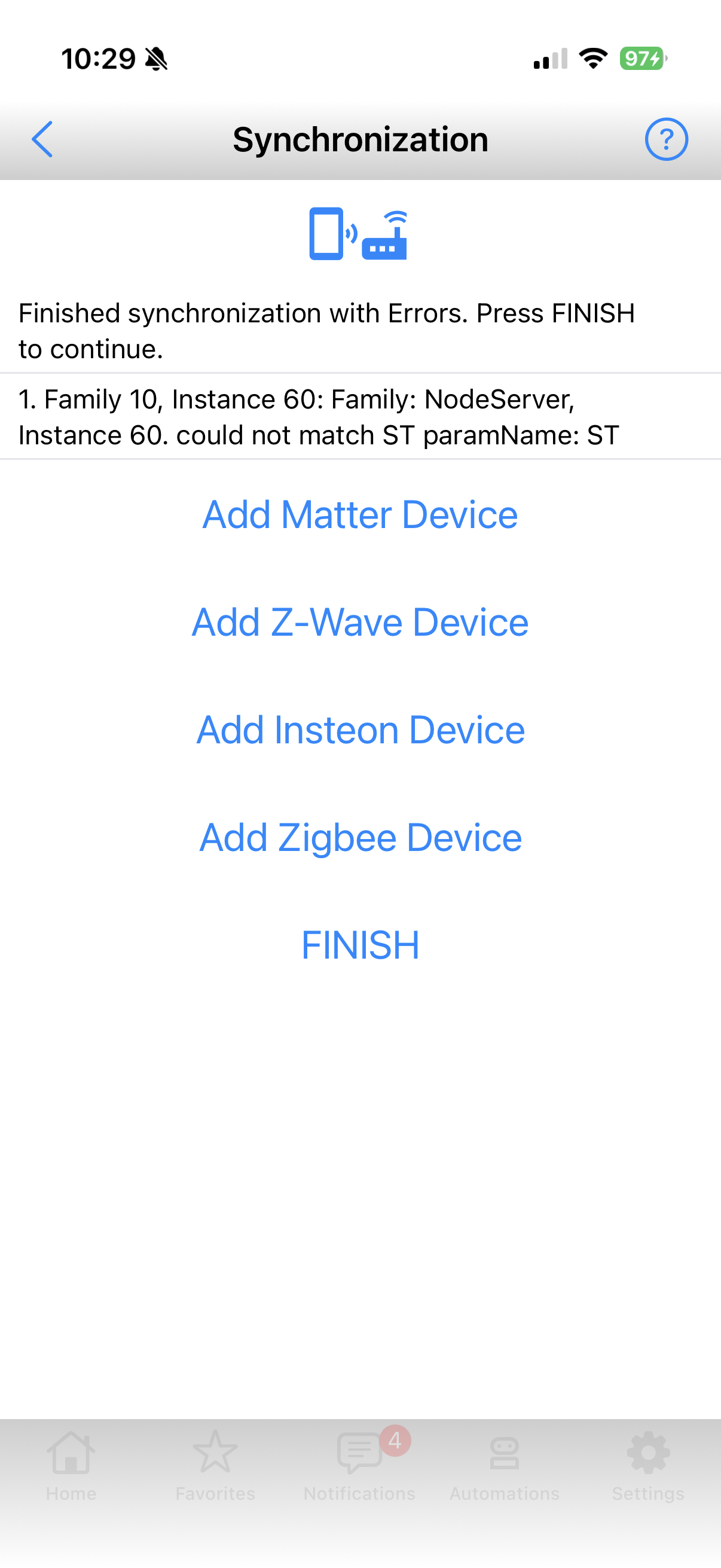

This is the error i am getting when synchronizing UD Mobile.

@Javi Is there any way to figure out what Family 10 and Instance 60 refers to? I guess the node (family) is in slot 10 but how do I know what Instance is - It would make debugging easier
Instance is the slot number, So Family 10 (node Server), instance 60 (slot 60).
