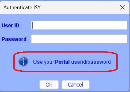

admin/admin fails login after updating eisy-ui 0.7.2
Upgraded the other day and thought all was good after upgrading to 0.7.2
Tried to login today using via IoX Launcher using admin/admin ... nope, then tried logging in with my backup user / pass nope
Noted the login shows "Use your Portal userid/password"

Thanks for the direction, I figured out what changed in my enviroment ...
IoX launcher dropped the 8443 from the network discovery IP showing
Everything that worked before continues to work the same way:
  • IoX will respond to API requests on port 8080/8443 and require the same local username & password

No, a portal subscription is NOT required.
The admin/pw in AC depends on what url you use in IoX Launcher.
- If the url is 8080 or 8443, this is using IoX local user and password
- If you see no port (which means it's implicitly 80 ot 443), then you need to use your portal password.
In addition, when you see the login box in AC, there is a line that says which user/password you should be using.
