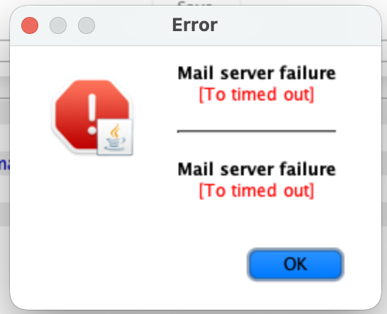

March 4Mar 4 Just made a quick change from SMTP @gmail toe "Use Default" and ran a test and it's back to working again. This is hit and miss.Uploading Attachment...
March 4Mar 4 34 minutes ago, PhanTomiZ said:So how does this setting affect my Gmail account and the ISY for the "TLS negotiation failed? Sounds like a google password/authentication problem?Nothing changes for your Gmail account. The change affects use of their smtp servers that you use to move email. It's well known that certain people abuse smtp to send spam and other garbage. Stronger authentication tries to ensure that the right people are using their smtp servers.ISY supports Basic authentication for their smtp servers, Google no longer supports Basic authentication for reason describe above. They say you have to use their procedure to generate an approved strong password (16 character) if you want to continue to use Basic authentication..BI now supports Oauth which allows you to use your usual Google username and password for authentication to their smtp servers. Edited March 4Mar 4 by mmb
