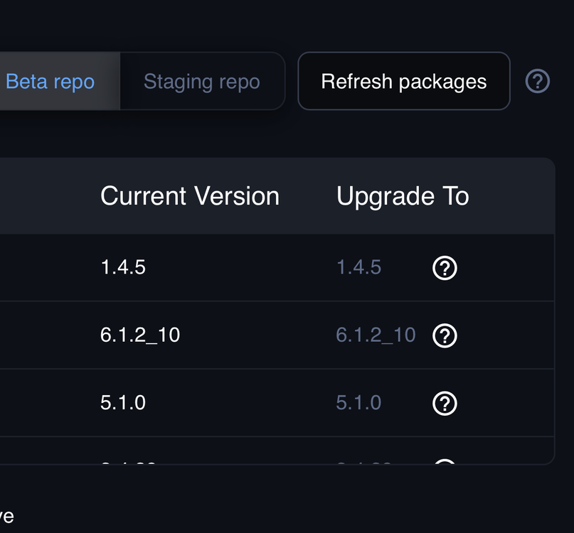

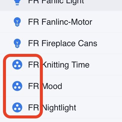

Scenes are in the Nodes Page, just as they are in Admin Console. Must be on the latest relasee.
They are intermixed now with all the nodes.....they have a different symbol:
Personally, I preferred them listed separately at the bottom as in the AC. They were much easier to find
Two way around this that I am contemplating: add them all to a new Folder called SCENES or change my nomenclature method to add a special character in front of all scenes to allow them to be sorted together

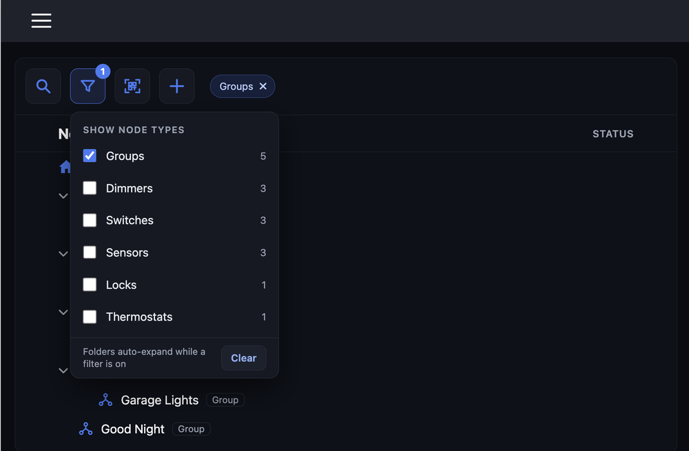

While we could sort by the type (folder/device/group), it is, and has always been imperfect. In AC groups can be added to folders so they are not always at the bottom. If we forced to always at the bottom it would break new sorting options eisy-ui (like name/status/etc).
Add to a folder or using folders as rooms/locations then adding the group into the room/location folder is the best of both options. Personally have a Scenes folder where I keep my Scenes based on room/location

Thanks to everyone for your help! I now know that Version info in System does NOT mean I'm up to date when Current Version and Upgrade To match! I did the Upgrade Packages and now I have SCENES although called something else. I'm learning a lot just by reading the responses to this thread.
Thanks to all again. I will likely be back as I work my way through these changes.
