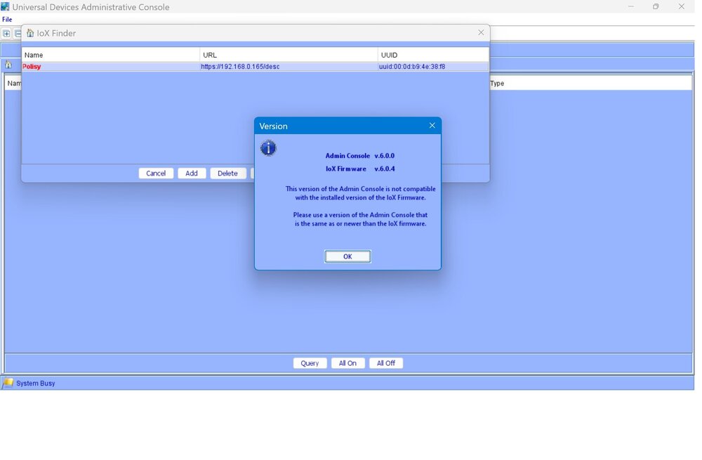

Saturday at 02:39 AM1 day I was notified up an update. I update. The console closes and I open it. But surprise! "The Admin console is not compatible with the installed version of the IoX Firmware".Not all of us live and breath Eisy. We just use it. Now I'm out searching these forums on how to update the console.Please help those of us that are not power users. Updates should not be painful in 2026.How the heck do I update the console? The program says not compatible, then I click OK and it closes. So now I can't open the console. UGH!I thought I saw a message many months ago that this was going to be simplified. Edited Saturday at 02:44 AM1 day by nowandthen
