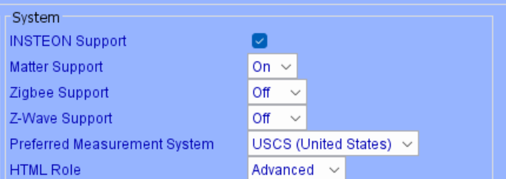

It would be interesting to have a bit more information about some of the items mentioned in the release announcement:
  • "Support for manual static ip config" is static IP configuration back? I'm not seeing it in the Configuration screen.
  • "Improved Matter support" what exactly? Reliability? Better device interview results?
  • Minimum previous version 5.9.1 What does someone do if they have a lower version? It's not like the isy994i where you can download older versions.
