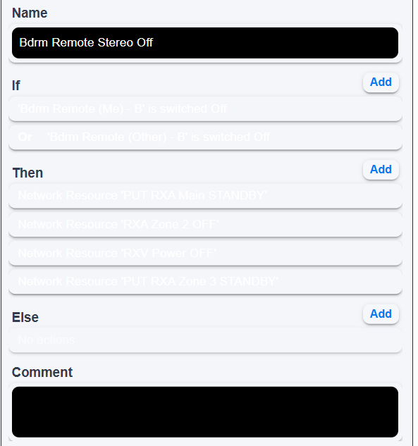

Theme toggle works although some text stays white when going to light mode.
ETA: I see you mentioned there are still issues.
Yes that is the issue in the current build, most should e addressed in the next release.

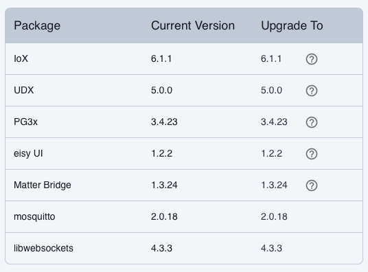

3 hours ago, Javi said:
Are you using the beta build
I am using whatever version shows up when one updates packages. I believe it shows IoX version 6.1.1
Edited by oberkc

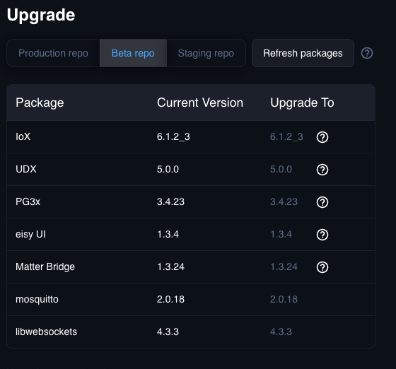

Today's announcements require beta build: Also light mode is not officially supported until the next version so Alt + t to get back to dark mode
